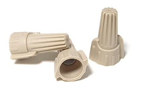

Step 7: Supplies
  • wire nuts (if you don't know what these are, look at the image above)
  • 2 long wires
Step 8: Connect
Strip a bit of the end of the wires off, and then twist the wires with the arduino's wires. Twist the wire nuts over the bare connections. Tape the other ends of the longer wires to the two faces of the piezo disc. Binder clip them after taping.
