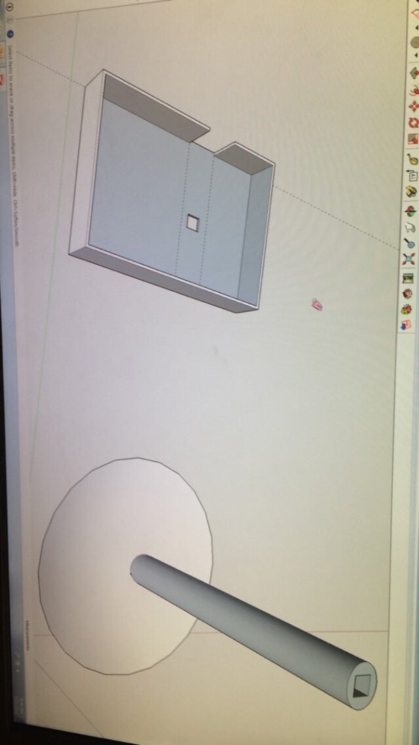

Step 2: The Sketchup Design
This sleek design encloses the Arduino hardware. The light of the candle is a Neopixel, programmed with the Arduino.

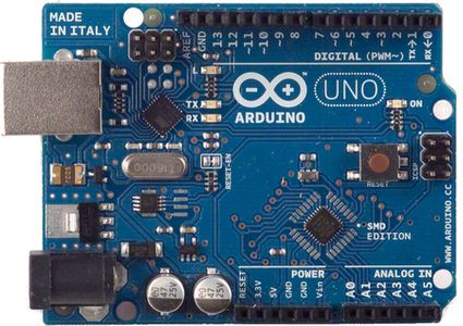

Step 3: The Arduino Hardware
A wire connects pin 7 to the top hole in the Neopixel.
A wire connects VIN to the left hole in the Neopixel.
A wire connects GND to the right hole in the Neopixel.
