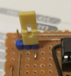

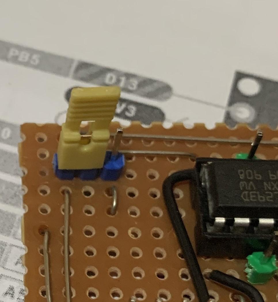

Power for the board can be either supplied via the USB socket, for very low loads, or via the power connection pins. An on off switch controls power from these pins and passes it to a MP2307 mini buck regulator, and to a jumper pin across the board. The MP2307 should be set to 5V output and provides power to all the positive pins on the board. A jumper allows selection of either regulated power (left position) or direct power (right position) from the switch to drive the robot motors.

Place the jumper in the right hand position.

Step 9: Solder the Regulator and Jumper
As supplied, the regulator has solder pads in each corner but no pins to fit the socket.
it is also sometime useful when the power supply to the board is already regulated at 5V to insert a jumper across the regulator socket.
Fit four individual PCB pins into the corners of the regulator socket. Place the regulator over the four pins such that all four pass through the corner solder pads. Holding the regulator in place, solder the four pins.
Cut a small piece of stripboard with strips running longways, 7 holes by 5 holes. Repeat the procedure for this piece of stripboard as for the regulator.
When this is inserted into the socket, the switch output is connected to the rest of the board unregulated.
Always check that the power supply is 5V or less before using this bypass.
