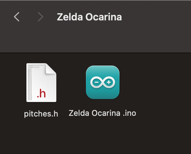

Then download my files make sure pitches.h and Zelda Ocarina.ino are in a folder together.
Open Zelda Ocarina.ino
It should look like the second screenshot.
Connect your Arduino to the PC with the USB cable, the program should automatically read that you connected it.
Upload the code to the Arduino by pressing the " Upload" button it is depicted as an arrow facing right
