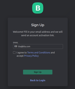

Step 3: Registering to Blynk
Go to the blynk website and create an account

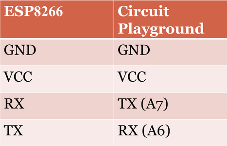

Step 2: Connect the CPX and ESP8266 Boards
  • Using jumper wires, establish the following connections:
  • CPX GND to ESP8266 GND
  • CPX RX to ESP8266 TX (A7)
  • CPX TX to ESP8266 RX (A6)
  • Connect the CPX board to your computer using a micro USB cable.

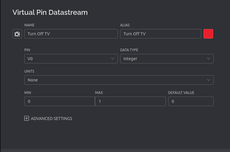

Step 5: Setting Up the Near-tV Device

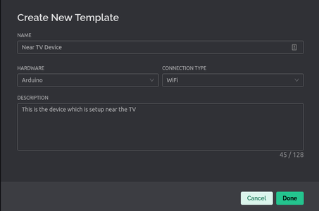

Create the template for our device:
  1. Login to your blink account
  2. Click on the "templates" icon on the left and then "create a template" at the top right
  3. Enter the template name and choose "Arduino" and "Wifi" in the corresponding fields.

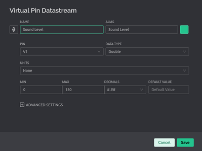

  4. After the template has been created, click on the "datastreams" tab
  5. Add the two datastreams, the first being the sound level, which is of type "double" and range of 0 to 150 and the second being "turn tv off" being an integer with the range of 0 and 1 with default value 0.
  6. Click "save" on the top right of the page

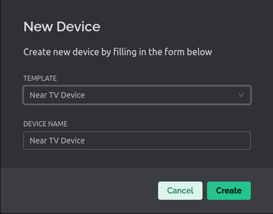

Now, let's create a device:
  1. Click on the "search" icon on the top left of the page
  2. Click on "New Device" at the top right of the new page opened
  3. Click on "from template"
  4. Choose our Near TV template and click create
  5. Copy the information the popped up on the top right of the page (the area with the "#define BLYNK_TEMPLATE_ID)
  6. Save this information.

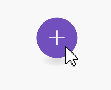

  3. Press the giant purple button.

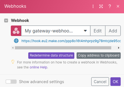

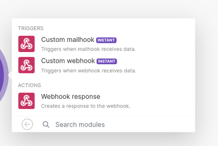

  4. Select webhooks
  5. Select custom webhook
  6. Select create a new webhook and press ok.
  7. Copy the url that was given to you and save it for the next section

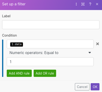

  9. To set up the filter option of the webhook you must test the connection from the blynk app to make.com using redetermine the data structure button inside the webhook.
  10. Once finished you can click on the wrench icon then set up a filter. Select data equals to 1.

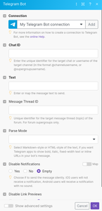

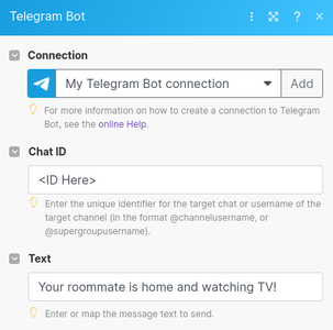

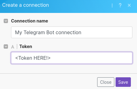

  11. Press the + button on the router and select the telegram bot option for the 2 new modules that were created.
  12. Inside the telegram bot menu press the "Send a message or reply" option. Then under the connection option press "online help" to set up the bot.
  13. Click here for the guide to get the chat ID needed for steps 14 and 15
  14. After setting up the bot get the chat ID for the responsible roommate and input the following to the message field: "Your roommate is home and watching TV!"
  15. On the other Module for the router set up the telegram bot in a similar way just for the lazy roommate with the following message: "Leave the TV Alone and GO DO THE DISHES"

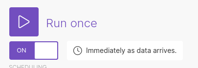

  16. On the bottom left corner turn on the schedule to run always and you are good to go.

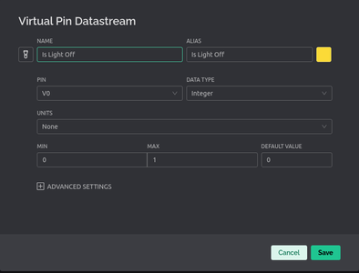

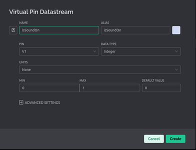

Step 8: Setting Up the Bedroom Devices
For this step we need to create 2 devices for the bedroom scenario.
Similar to step 4 create 2 templates for 2 devices with the following pins and names:
  1. Bedroom Device containing the following virtual pin: V0 = isLightOff (type integer, range 0-1, default 0)
  2. Bedroom Sound Device containing the following virtual pin: V0 = isSoundOn (type integer, range 0-1, default 0)
Add 2 devices, 1 for each template (don't forget to alter for each device the #defines received from the blynk website).

  6. Add a telegram bot module sending a message to the good roommate letting him know that the bad roommate entered the bed but that the blynk server is taking care of it.
  7. On the other route add another telegram message to the bad roommate sending him to get out of bed.

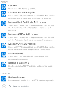

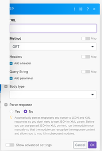

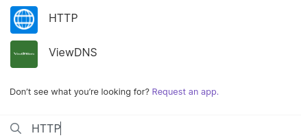

  8. Then add another module after this one sending an HTTP request to the blynk server external api
  9. The request url is the following: https://sgp1.blynk.cloud/external/api/update?token={YOUR_AUTH_TOKEN_FOR_BLYNK_DEVICE}&V0=1

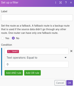

  10. Coming back to the first router add a route filtering all instances where level equals to 0.
  11. Add another HTTP module sending an HTTP request to the blynk server external api where the url should be: https://sgp1.blynk.cloud/external/api/update?token={YOUR_AUTH_TOKEN_FOR_BLYNK_DEVICE}&V0=0

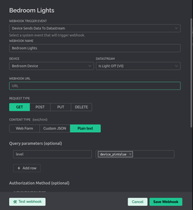

Step 10: Blynk.Com Bedroom Webhook Setup
  1. Go to Blynk.com
  2. Press the settings icon in the lower left
  3. Press under the development category the "webhooks"
  4. Click on "Create a webhook"
  5. Set the "WEBHOOK TRIGGER EVENT" to "Device Sends Data To Datastream"
  6. Set the "WEBHOOK NAME" to "Bedroom Device"
  7. In "DEVICE" choose the "Bedroom Device" and in the datastream to "Is Light Off V0"
  8. In the "WEBHOOK URL" place the url from the previous step
  9. And finally in the query parameters set the "Key" to "level" and "value" to "device_pinValue"
