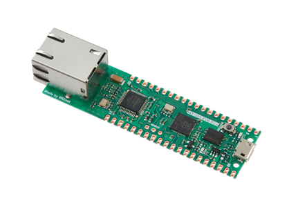

Introduction: Arduino Raspberry Pi Pico/RP2040 Ethernet : W5100S-EVB-Pico
Mr. Philhower's 'arduino-pico' is one of the easy ways to use Raspberry Pi Pico with Arduino IDE.
I added the modified Ethernet Library.
I introduced 'W5100S-EVB-Pico with the Arduino IDE' by using the Arduino-Pico of Mr. Philhower before.
But there are some points the user needs to download WIZnet Arduino Ethernet and change the default library to use.
So, I've decided that I would make an Arduino-Pico includes WIZnet Arduino Ethernet as default.
Maybe it is unnecessary if the default Arduino Ethernet Library supports the W5100S. But it doesn't support the W5100S until now.

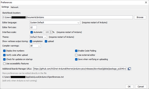

Step 2: Additional Boards Manager URLs
You can add the URL in the "Additional Boards Manager URLs" field and search pico or ethernet in Board Manager to add.
https://github.com/WIZnet-ArduinoEthernet/arduino-pico/releases/download/global/package_rp2040-ethernet_index.json

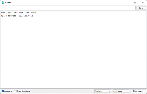

Step 7: Serial Monitor
Then run a Serial Monitor.
You can see the allocated IP address.
