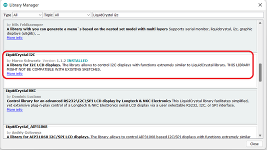

For this project, you will need two libraries:
  • the first one (for the LCD Display), you can find it in the "Library Manager" : go to the top menu of the Arduino IDE then click on Tools => Manage Librairies, then type LiquidCrystal in the search bar then choose the library schowen in the picture above then click on "Install".
  • the secod one (for the real time clock DS1302), you will find it here : http://www.rinkydinkelectronics.com/library.php?id=5 you need to download the file DS1302.zip. Once the Zip library has been downloaded, import it within the Arduino IDE. To do this, go to the top menu, then click on Sketch => Include Library => Add .Zip Library. Then, find the Zip file in the folder in which you downloaded it, then select the Zip file and click on "open".
