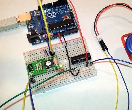

Step 2: Connection Lcd to Arduino
Connect pins 1,3 and 5 to the Arduino’s GND. (Doesn’t matter which one)
Connect pin 2 to the Arduino’s +5v
Connect pin 4 to the Arduino’s Digital Pin 12
Connect pin 6 to the Arduino’s Digital Pin 11
Connect pin 11 to the Arduino’s Digital Pin 10
Connect pin 12 to the Arduino’s Digital Pin 9
Connect pin 13 to the Arduino’s Digital Pin 8
Connect pin 14 to the Arduino’s Digital Pin 7
Step 3: Connecting the Joystick
Now let’s move onto the thumb stick, I’ve color coded all 6 pins on the thumb stick, each direction is Red, White and Black, they represent +5v, Analog signal and ground respectably.
Hook up the black wires into the ground rail, and the red wires into the +5v power rail, connect one white wire into analog in 0 and the other into analog in 1
