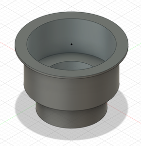

Cup Holder
To hold the water I decided on an inset cup holder that can hold a maximum diameter bottle of 4 inches, it also has a smaller lower portion to hold smaller bottles with a diameter of 3 inches. It also has a small hole at the bottom to let the liquid drain out so it doesn't pool up.

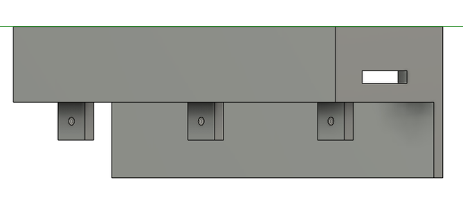

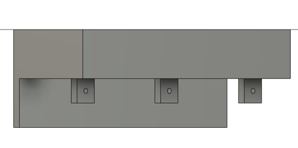

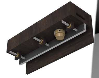

To make this project work well for different bed frames the part that attaches to the sideboard of the bed must adjust to different widths. There were many different options for how to make the part adjust, but I decided on a piece that holds a bolt with threads that are connected to a plate. The plate and bolts slide through the holder. When you find the right place for the plate to be, there will be 2 nuts on either side of the holder that you will tighten that will make sure the plate and bolts do not move.

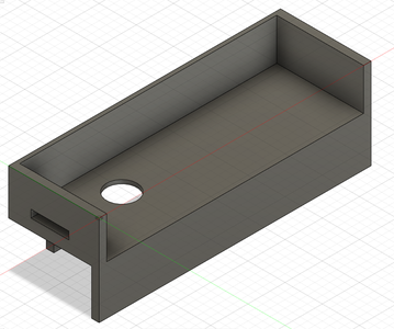

Step 2: Designing the Main Body
Now for the fun part, getting into Fusion 360 and actually making the final design. The main body is 3 feet wide and 1 ft deep. The wall height is 6 inches. The front face is 12 inches tall and the holder is 3 inches high on the bottom of the body.
The thought process behind the design of the main table body is that there are high walls to protect things from falling off the side of it or being knocked off. It also serves the purpose of making it large and easy to see so you don't bump your head on it if it is up high.
Step 3: Designing the Cup Holder
The cup has an internal diameter of 4 inches at the larger end of the cup. The smaller end of the cup has an internal diameter of 3 inches so smaller cups can be stable. The cup holder has an overhanging piece that you attach to the main body, the outside diameter of this piece is 4.75 inches and an internal diameter of 4 inches. The diameter of the small drainage hole at the bottom is .1 inches.
The reasoning behind designing the cup holder the way I did was that I knew there are many different sizes of water bottles that people could own, so the cup holder must accommodate ad many bottle sizes as possible. I did some tests with my large 1500 mL water bottle. I designed the larger portion around the large 1500 mL water bottle, I made sure that it fit inside the cup holder, so anything smaller should be perfect for it. The small portion of the cup holder was designed around a standard plastic Ice Mountain water bottle.
The drainage hole was put in so if needed liquids could drain out of it and not pool up and become disgusting. I made the cup holder removable to allow it to be easily cleaned. It is also useful for transport, so when you transport the body you make the shape more normal and easier to transport.
Step 4: Designing the Holding Plate
The main face of the holding plate is 3 feet wide, to allow for the most surface area possible to be touching the baseboard, allowing for greater stability. The baseboard is also 3 inches high, and 1 inch deep. The screws that connect the holding plate to the main body are positioned 1.5 inches down from the top of the holding plate. The screw closest to the sides is 3.5 inches from the sides and the 3 screws are 15.20 inches away from each other.
The screws are 8 inches long with a diameter of .75 inches. The thread for the screws is 3/4 - 10 UNC in the 3A class. The nuts are fairly standard being, 2 inches in diameter and have a hole diameter of .75 inches. The nuts also have the 3/4 - 10 UNC in the 3A class threading for their holes.
