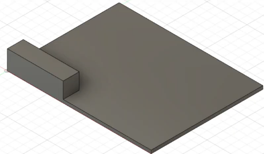

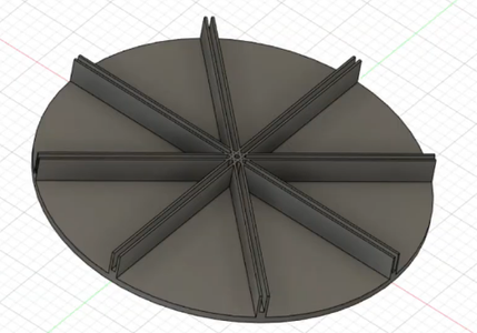

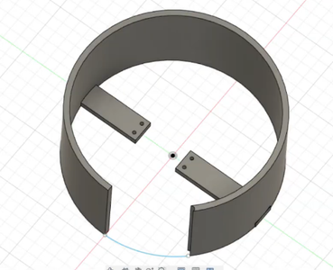

Step 1: 3D Design
I have used Autodesk Fusion 360 for Designing and also added initial drawings of system

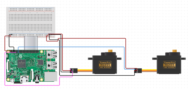

Step 2: Overview of System
I am used Raspberry Pi 4 as Main controller with 2 Servos as actuators.
Mobile App is made using Flutter.
And all Medicine Schedule Data is stored in Firebase and is synced on Raspberry Pi
Step 3: 3D Printing
The models took total of 12 hours to print in PLA at 4% infill . I added Cardboard supports due to failed 3D Prints.
Step 4: Mounting Motors
Mount both Servo motors using screws and for Door use some Glue

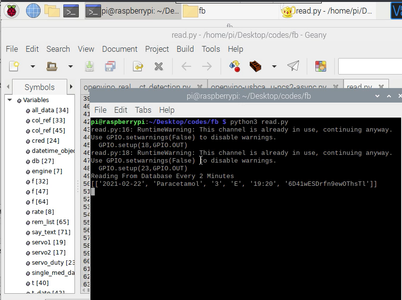

Step 6: Run the Raspberry Pi
To start the setup, first connect the circuit and usb speaker. Then run the code from Github Link
Raspberry Pi Code
