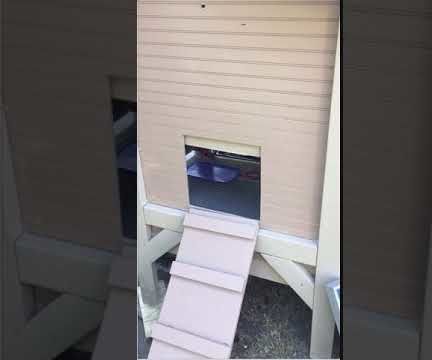

This guide is also part of an automated chicken coop project, shown in the second picture. (All builds are still needed to be relocated into a run, so the horse are coiled together.)
