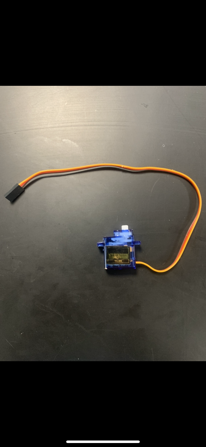

- Micro Servo Motor + servo arms provided and wires

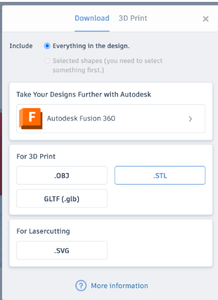

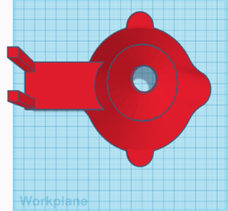

First access the Tinkercad file where the design parts were created. To export the design to print, click the export button in the top right corner of Tinkercad and select .STL when the menu appears.

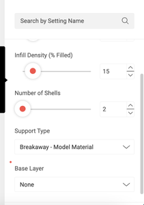

Step 3: Confirming MakerBot Settings
In the bottom right corner of MakerBot titled, “Quick Settings,” “breakaway supports” should be selected as the default. Also in settings, the “Base Layer” dropdown menu should be selected as “None”

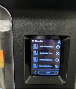

Select the “Export” button in the top right corner. A .makerbot file will automatically download onto your computer. At this point, a flash drive must be connected to the computer and the .makerbot file should be dragged onto the drive.
Step 5: Different Steps of Printing
- Once the .makerbot file is on the flash drive, detach it from the computer and plug it into the 3D printer. When attached, the flash drive will appear on the printer menu. Select the title of the .makerbot file you downloaded and select print.
- The printer should list the time it will take to print the device. This device consists of the funnel, the small “door,” and the 2 stands. It is a good idea to print the components individually as the build plate is a small space.

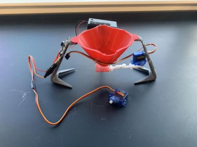

To begin, apply small amounts of hot glue to the tops of the stands and attach the “lips” of the funnel on top of the glue. Ensure the two stands are glued across from each other enabling the funnel to “stand up.”

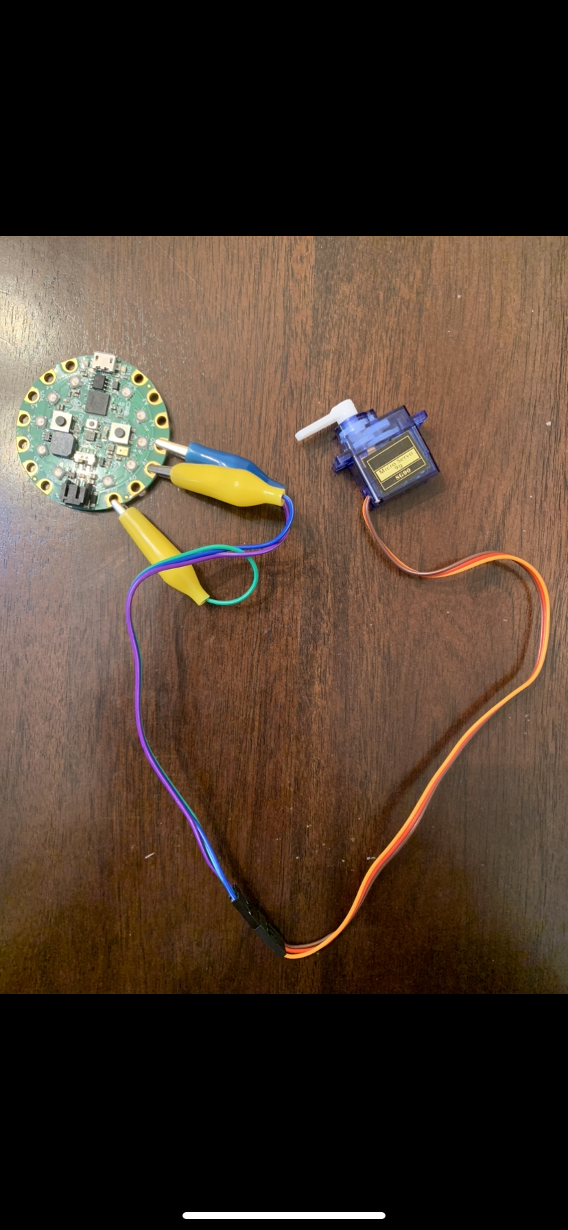

Step 7: Wiring CPX and Servo
Next, wire the Micro Servo Motor to the CPX device using the specific wiring system of, the GND CPX port connected to the brown/black Servo wire, the A1 or A2 CPX port connected to the orange/yellow Servo wire, and the Vout CPX port connected to the red Servo wire.
Plug the battery pack into the CPX and place the battery on the shelf that is attached to the printed funnel.
Step 8: Building Your Model

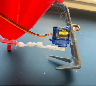

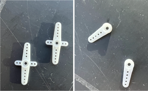

To attach the Micro Servo Motor first glue 2 full Servo Motor arms and 2 half Servo Arms in a straight line together and attach to the motor. Glue the square “door” to the end of the line of arms.
Glue the Micro Servo Motor in between one stand, wrapping the wires around the funnel. The proper placement of the motor is in between the stand where the door lines up with the bottom of the funnel, enabling the door to swing open and release food before returning back to a starting position covering the funnel opening.

- Download and print the following STL files using a 3D printer. Select no raft and supports. The design can be found in the attachments of this step
- These files were designed using TinkerCAD
