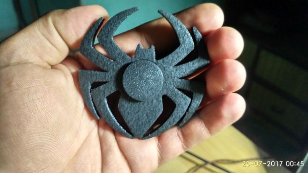

In this Instructable we will be building a Spiderman Fidget Spinner with just only one bearing.

Remove the 3D printed parts from the Heated Bed and then press fit the bearing inside the provided hole.
And then again Press Fit the Upper and Bottom caps on to the bearing.
And your very own fidget spinner is ready.
Now You can test run it and enjoy.
