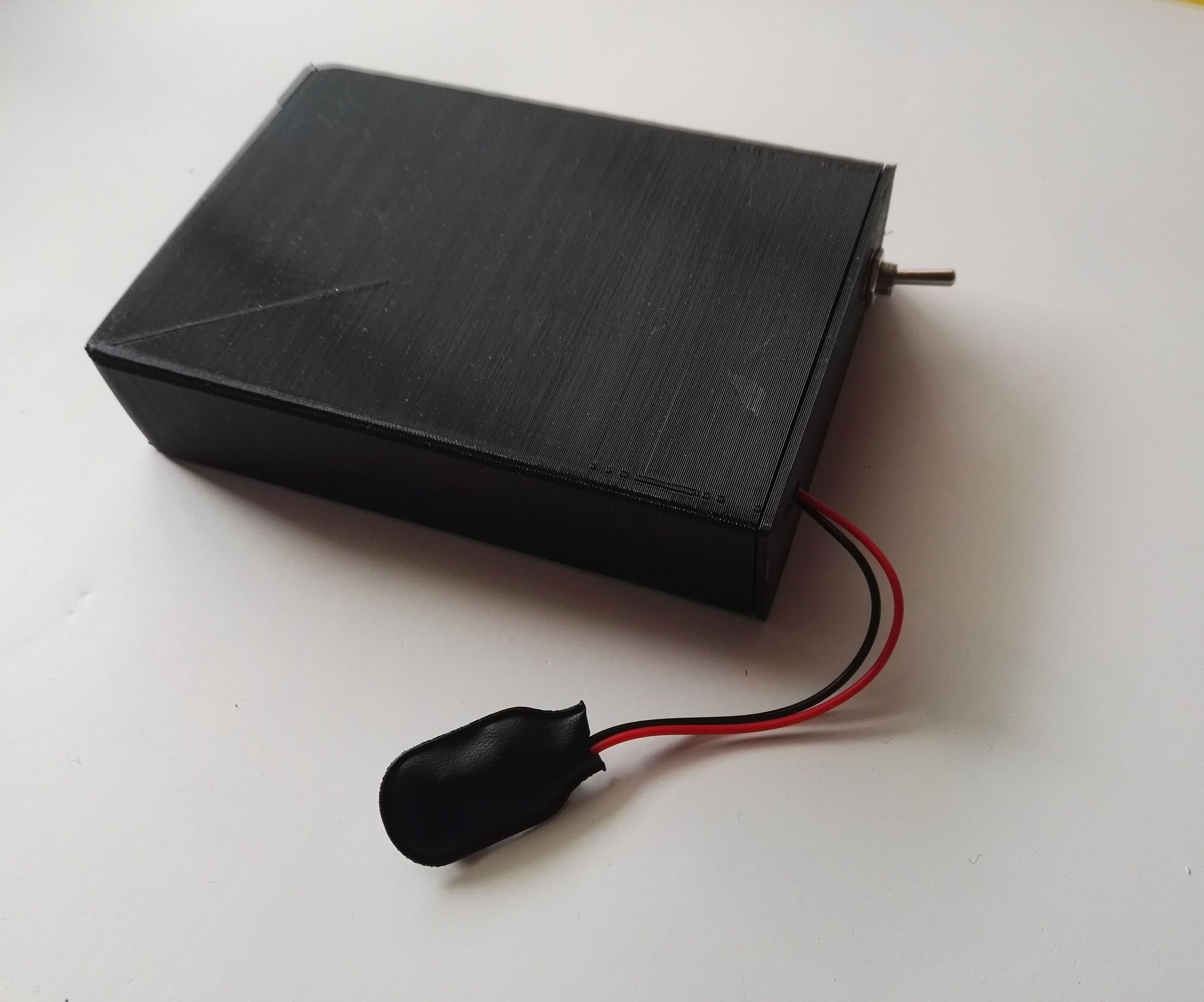

Step 2: Soldering... ;(
This is the ennoying part of this project.
You can see the diagram below.
I used thin non-isolated copper wire for the connections.
I also recommend using a small slide switch to turn the device on / off.
I printed a little case for my 18650 Li-Ion battery. I will put the .stl-files below.
i have also 3d printed knob for the Encoder (.stl-file below...)
