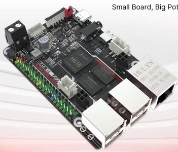

Step 5: BTT-Pi Setup
About:
The bigtreetech Pi (BTT-Pi) is a small computer that imitates the Raspberry Pi 3b. It comes at a much lower price but the documentation is minimal and software packages which are designed for a Raspi struggle with compatibility problems. The main application of the BTT-Pi currently is running Klilpper for 3D-Printing.

The BTT-Pi has its own GPIO Pins and certainly the capacity to control the sensors and motors by itself. The reason why this is outsourced to the Arduino Uno is that there is no Documentation or library for controlling these Pins as of today. Hopefully BigTreeTech will release something like that asap.
