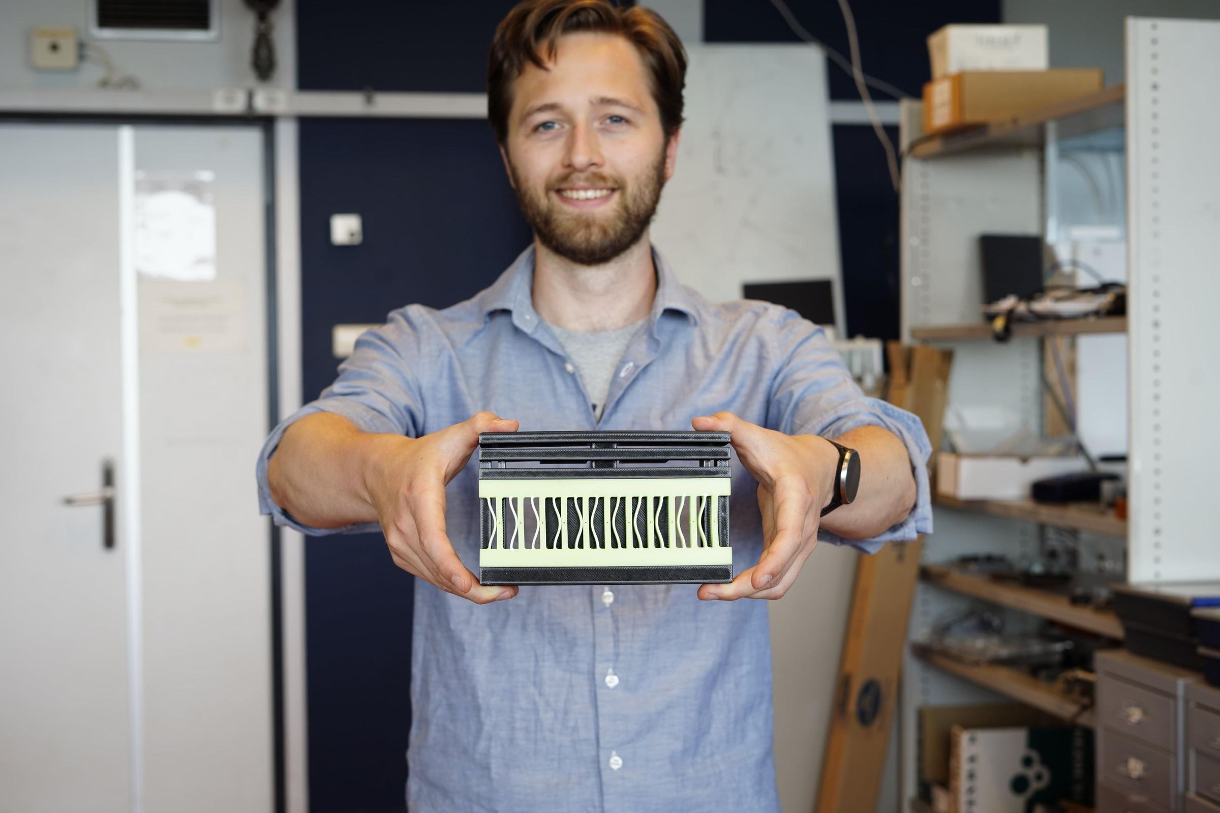

Introduction: Beam Counter: a Rubber Block That Counts!
About: PhD candidate working on establishing the connection between computers and materials.
Rubber doesn't usually have a lot of memory. Contrary to a sheet of paper, when you deform a block of rubber, it just springs back. But by changing the structure of the rubber, we can change its mechanical properties. We can make a metamaterial out of the rubber that does have memory. Specifically, we can make a material that counts how often you compress and decompress it. It works with thin beams that buckle and bend left or right, acting as our material bits. We design these beams so that they bump in to each other to perform a simple operation similar to counting. As can be seen in the video, every time I compress and decompress, one more beam is flipped to the right.
