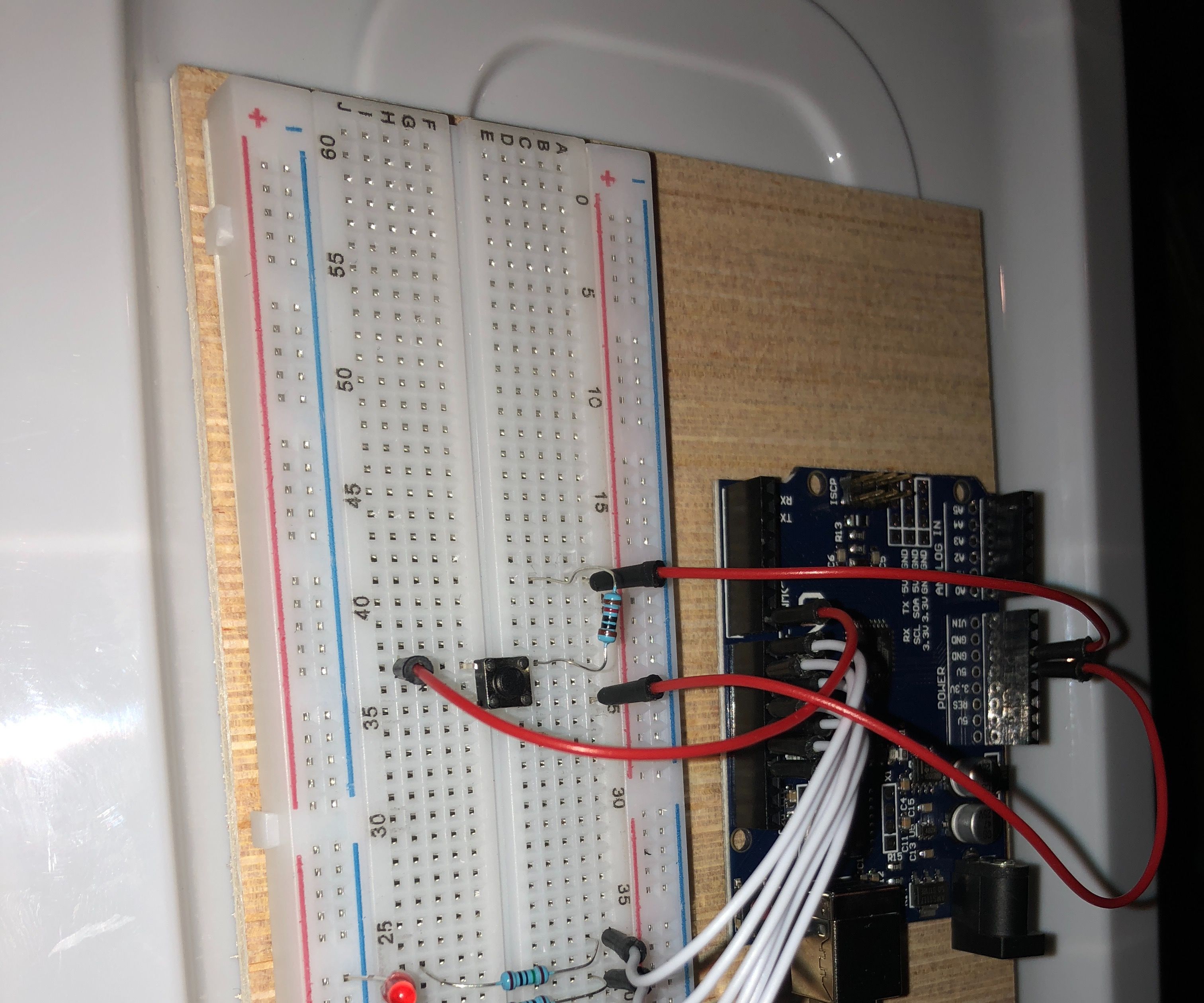

Step 2: RGB Neopixel Light Strip
Now that the table has detected impact, the white and blue wires connect to the same Arduino as the RGB Neopixel Light Strip:
https://www.amazon.com/gp/product/B014QZNC1S/ref=oh_aui_detailpage_o03_s00?ie=UTF8&psc=1
The Neopixel Light Strip is connected using the green as the information wire, the black as ground, and the red as power. Pardon the poor picture, as it was taken before I soldered everything onto the Arduino; however, below the connections are listed for the pins. There should also be a 1 MOhm resistor connecting the white and blue wire pins.
Connections:
Blue- A0
White- Ground
Red- 5v
Black- Ground
Green- 6
The code that I have compiled senses when there is an impact on the table (using an adjustable threshold), and then lights the Neopixels up Green for one second if an impact is detected.
