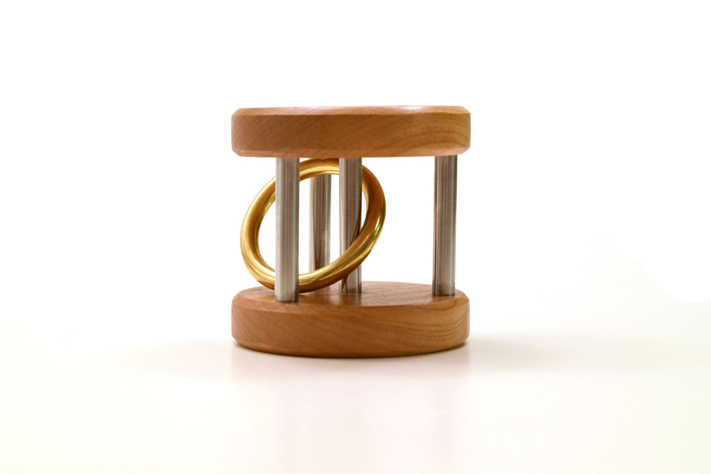

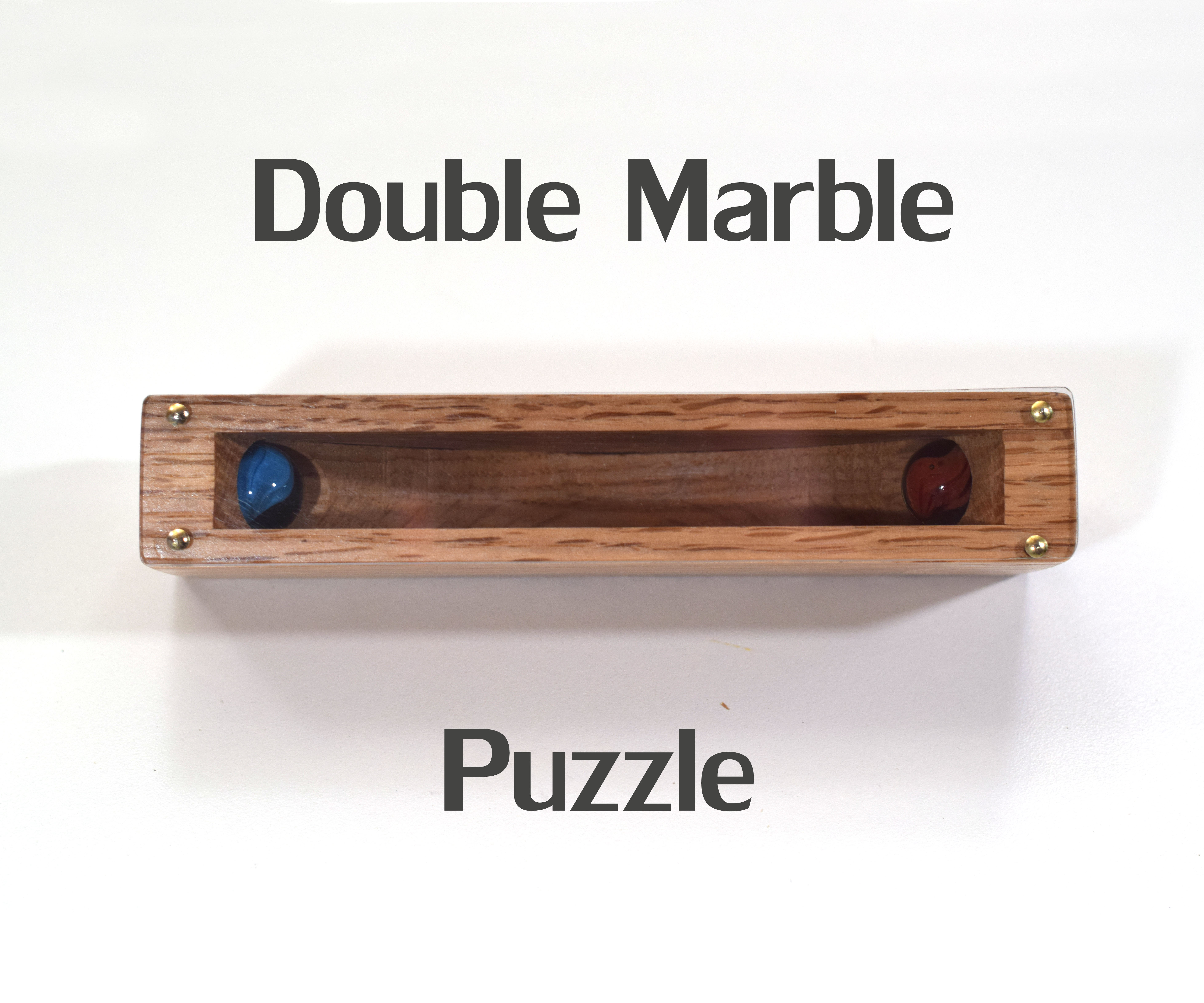

Step 47: Enjoy Your New Tool!
Now that your new disc sander is complete, enjoy it! Make something useful with it! I used this tool many times over the past year (when I got distracted by other projects before it was complete). It was extremely useful for these projects (clicking on these images will take you to those projects):
What projects have you made with your disc sander? Have your made your own sander? I want to see them in the comments!
