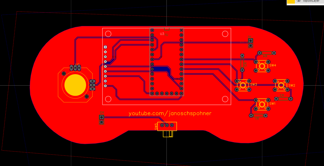

Step 4: EasyEDA - Designing Your PCB Part 1 (Setting Up Your Components)
After clicking Convert to PCB, you will get a dialog box in the PCB design environment prompting you for some basic settings, chose your units; mine will be mm (metric is superior, change my mind), you want 2 copper layers (GND and VCC), and you can leave the rest alone because you will delete the rectangular board outline to replace it with the DXF file we made earlier. Click Apply.
Again, make sure you save your work periodically while in the PCB design environment.
So this environment is similar to the schematic environment but there are some major differences to watch out for. The biggest being; which layer you are working on which is signified by the pencil in the "Layers and Objects" box. In the top right is a colorful box called "Layers and Objects". The layers you will be working in are "Toplayer", "BottomLayer", "TopSilkLayer", "BottomSilkLayer", and "BoardOutline". Another super helpful thing is the Grid size and Snap Size on the far right panel. I keep my Grid size at 50mm and I'll change my snap size based on how specifically I want to place components. The smaller it is, the more specific you can get and if you set it at 1mm - 5mm it can be very helpful in lining up your components.
Anyways, you should see a big pink rectangle which is the default board outline, click on it and delete it. All your components should be below that outline, jumbled together, we will worry about those in a minute. Go to the top left next to where it says EasyEDA in blue and click on the folder > Import > DXF... Again make sure you have the correct units and make sure the Layer you are importing this DXF to is the BoardOutLine Layer. Then click "select a DXF file..." and pick yours from where ever you saved it and then place it somewhere on the grid (I prefer the origin at 0,0 which you can see on the rulers at the edge of the black background). Zoom in on your board outline and make sure that there are no gaps, if there are gaps, just click on one of the lines and drag one of the green dots to close the gap. As long as there is overlap, you are good to go, don't worry about the lines not snapping together. Just make sure you make your snap size something really small like .01mm before adjusting the green dots.
If you really want to, I'll upload my DXF file here so you can use it if you wish, I just wouldn't recommend it as I threw it together in 5 minutes to make this instructable to make sure I wasn't skipping any steps, so it's just not that good.
Once you have your board outline ready to go, you can start placing your components however you want. just click and drag. I will put the screen in the middle, the Joystick on the Left, the four buttons on the right, the Teensy, four resistors and two Male Headers will go on the back. I only place the resistors on the back so I have more room when soldering the buttons but it's not required. Also, the Headers don't technically need to be on the back either since they are just two holes but when they silkscreen the boards you will have the outline drawn on the back and I will add "+" and "-" symbols later to remind me how to plug in the battery and piezo. To place a component on the back, select it, look on the right under "Component Attributes" > "Layer" and select "BottomLayer".
Tips for placing components; think about how your fingers would sit and interact with the joystick and buttons, don't be too close to the edge of the board but don't be too far to the center. Make sure the Teensy is placed so that you have easy access to plug it in. Place the Switch so that the part that moves is hanging off the board. Try to watch the blue lines a little bit and try to keep them from crossing. See pictures for clarity on placements.
Step 5: EasyEDA - Designing Your PCB Part 2 (Connecting Everything and Finishing Your Board)
Okay, once you have your components where you want them, now we start dealing with the mess of blue lines. If you hover over the points (or zoom a lot) connected by the blue lines, some of them say GND or VCC, if this is the case you don't need to connect them, they will be connected by the planes, don't worry you'll see later. To connect the other components, go to "PCB Tools" and use the wire tool (looks just like the wire tool from the schematic). Click on one end of the blue line and create a path that doesn't hit any other paths or component connections, besides the one you are trying to connect to. When the pencil is on the top layer (red square), you will be drawing paths on the top layer, if you click on the blue square, you can draw paths on the bottom layer which can help you avoid other paths. This part can be frustrating as there are many paths and connections you need to avoid. You may have to move around or rotate the buttons (or other components) to try to get less crossing blue lines, once you do, I recommend working outwards from the middle of the board to connect all components.
See my picture for how I ran my paths, note that I only had to use one blue path on the BottomLayer of the board to avoid crossing into another path on the TopLayer.
Once you have all non-VCC and GND connections wired up, use the copper area tool (dashed rectangle under the first Pacman looking tool on PCB Tools tab) to connect them. Click on the copper area tool, then draw a rough rectangle all around the board outline, right-click to complete it. If you were editing the top layer, this should have turned the board red, click on the red rectangle that is now surrounding the outline, go over to the right where it says CopperArea Properties and make sure the Net says GND. Now go and edit the Bottom layer and do the same thing, but make the Net; "VCC", this should remove the remaining blue lines. Go over to the left where it says, Design Manager and make sure it says you have all your nets connected, run a DRC Error check by clicking the refresh arrow next to "DRC Errors". If it still says (0), then your board is completely connected.
Now that your board is functionally finished, you can add text on the front or back by adding text to the TopSilkLayer or BottomSilkLayer. The Text tool is the T in the PCB Tools Panel. You need to click on the eyes next to TopLayer and BottomLayer in order to see any test that you place on the BottomSilkLayer. I will also add text next to my header pins to help me identify which pin does what when I get the physical board.
If you decide to move any of your components and this messes up the copper area, click on the copper area rectangle and then click "Rebuild CopperArea" under the CopperArea Properties tab.
If you think you will be making a case you will need a way to attach the PCB to the case. The way I think makes sense is to put some holes into the PCB board which you can do by using the "hole" tool which is located in the top right of the PCB Tools panel. You can place the holes by clicking and then when you are done, click on them again to access the properties tab. here you can change the diameter of the hole to fit a screw that you would use or whatever you would be using to attach the PCB to your case.
Save your work.
If you click on the camera in the top toolbar, then click 3D view, you can view your board in 3D. Notice how the 3D model shows the silkscreen outlines for each component and the text that I added.
Congratulations! Your board should now be completed which means you can order it to be manufactured! To do this, click on the G in the top toolbar (next to where it says BOM) to create your Gerber file which is what manufacturers use to build your boards. It will ask you to check DRC again, I just say yes even though we already did it. Then choose how many you want, what color you want your board and leave all the other settings the same. Then click "Order at JLCPCB", you'll be directed to a JLCPCB webpage which is the manufacturer. It should cost under $10 and be at your doorstep in less than 2 weeks.
