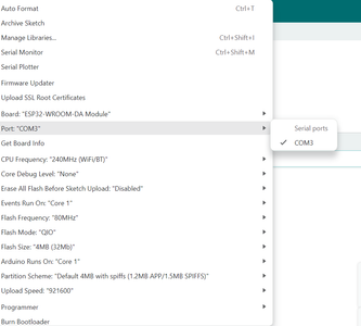

You can do this by opening the Arduino IDE and got to Tools Menu -> Port option.
If the serial drivers are already installed then the Bharat Pi board would be detected and shown as in below image.

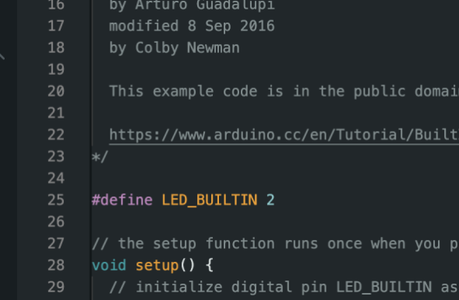

Bharat Pi boards have an onboard LED which is connected to PIN number 2 and can be used as an indicator for any of the programs or applications you will build using Bharat Pi.
To blink the LED let us use a test program readily available within Arduino IDE. Go to menu option File -> Examples -> 01.Basics -> Blink as show in below image.
The Blink led program opens and now let us set the LED PIN number for 2 in the code, this will be the pin number for the Bharat Pi onboard LED. Add a define statement “#define LED_BUILTIN2” just above the “void setup()” line as show in figure
Once the above code change is made then upload the firmware program to the board by clicking on the upload button on the top left side of the Arduino IDE or from the menu Sketch -> Upload option. You can observe the program compiles and the upload progress can also be seen in the output window of the Arduino IDE
Once the program upload completes the board automatically resets and boots. You should now be able to see the onboard LED starts blinking upon every 1 second time interval. You can change the delay time interval in the code and experiment the different time delay and the LED blinking intervals.
