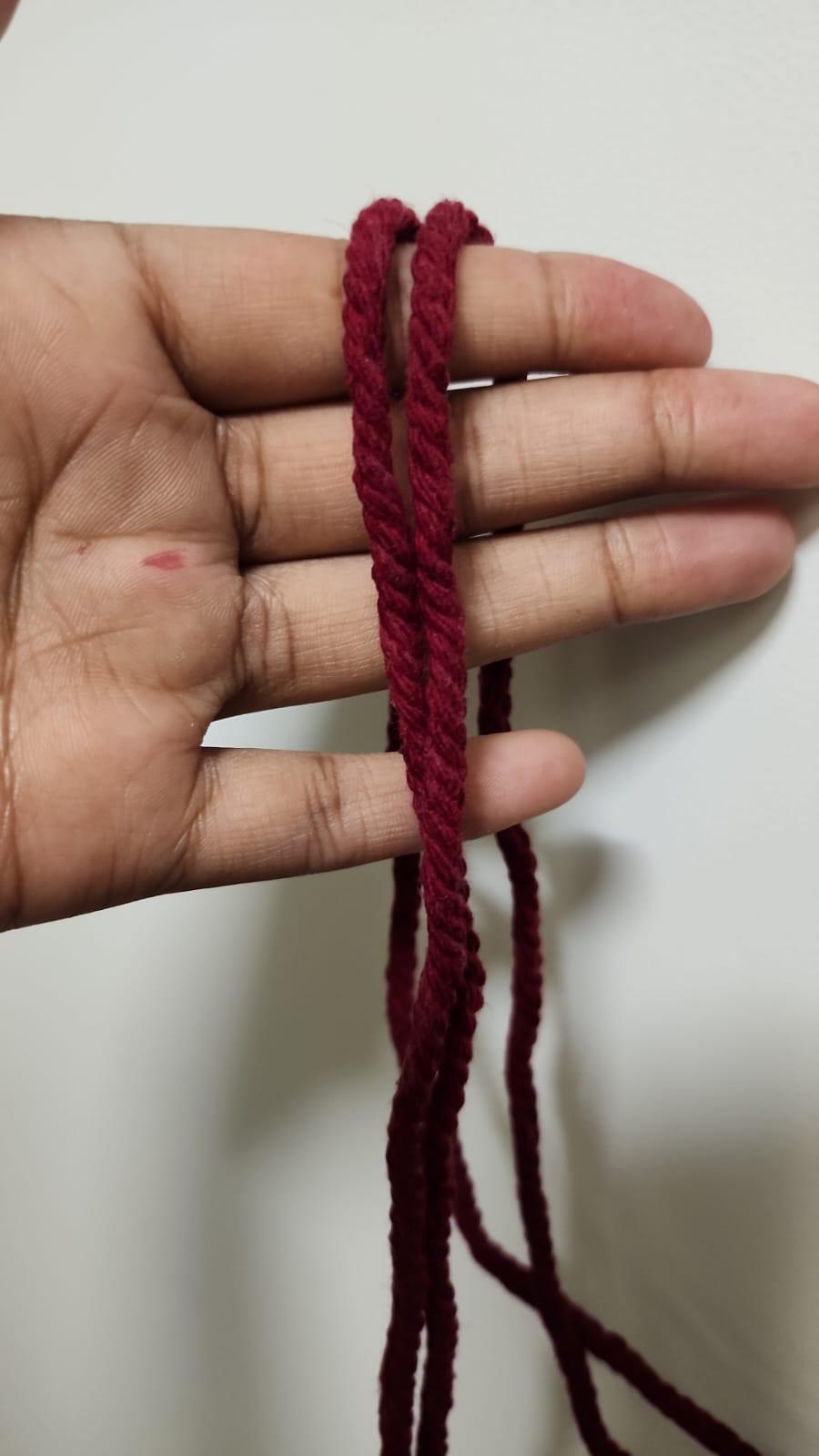

Dying the cotton twine:
  1. Pour the food colouring into a plastic packet
  2. Cut long Strips of the twine
  3. Put it in the plastic bag with the food colouring and let it soak in the coloring for a few hours

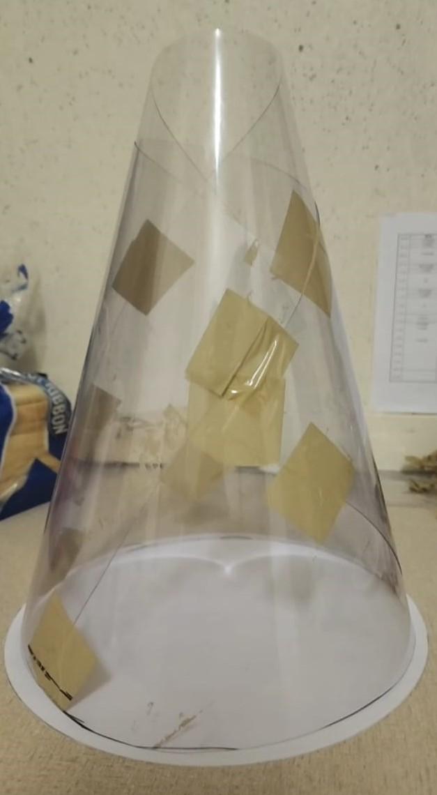

Step 2: Making Moulds
This stage is basically a trial and error and is dependent on how big you want your light.
The two equal pieces:
  1. Figure out the overall size of the light
  2. Then you would in a sense divide this by 2

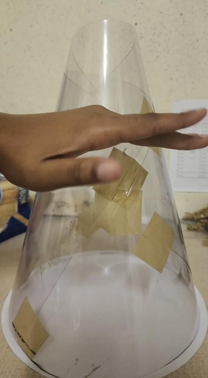

  3. When cutting your plastic to mould, make sure that you cut more than what you have estimated for the size of the two pieces (which are equal in size). This is because when making it you will be forming a cone with a rectangle piece of plastic by meeting/overlapping their ends. How wide the bottom of the cone is depends on how you twisted and overlapped the ends. Use sellotape to hold it in place and if you aren't satisfied with it, remove it and try again.
  4. Once satisfied, you will mark where you will be cutting the excess from and have the size you want.

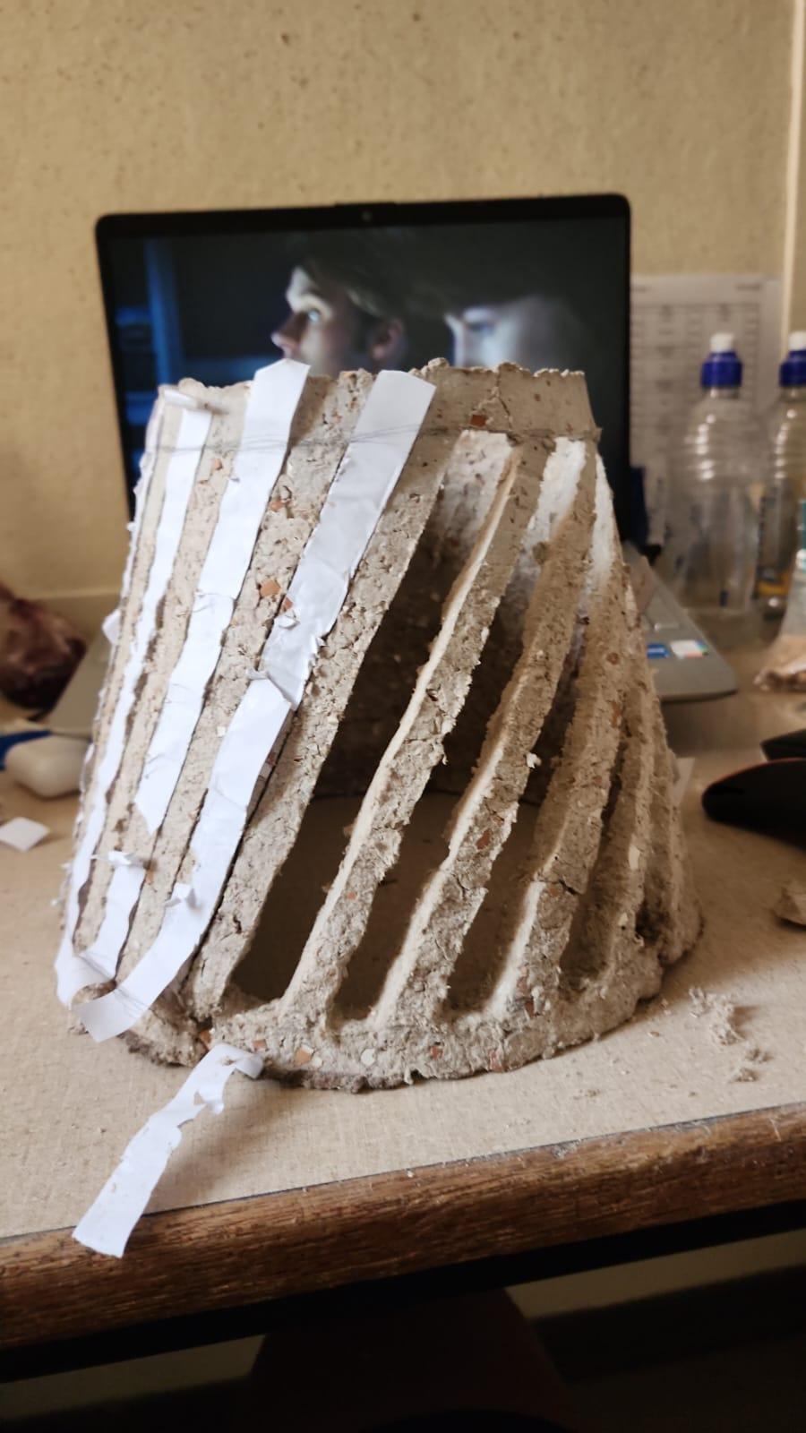

Step 6: Cutting Slots
On the third piece, mark where you are going to cut slots using strips of paper. Use a glue stick to stick the paper to the part.
Use a craft knife to patiently cut your slots. Be careful not to be rough so you don't damage the part as it is fragile.
Step 7: Tying the Cotton Twine
  1. When the cotton twine has soaked up enough of the food colouring, wearing the gloves, squeeze the excess food colouring out and leave them out to dry.

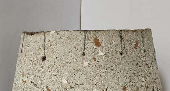

  2. After drying, poke holes in the first and second pieces of the light for the "sewing" part. I used the sharp point of a mathematical set compass but anything sharp to create a small but big enough hole for the twine will suffice.
  3. Cut long enough strips of the twine that you can tie knots at both ends while also considering the distance between the top and bottom.
  4. Pull the twine through one part and tie it in a knot and then pull it through the other part and tie a know too.
  5. On the top piece, poke four holes which you will use to pull the twine through them to hang the light.

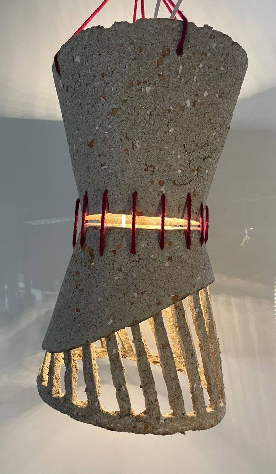

Step 8: Connecting Last Piece
The last piece with slots is then connected to the middle piece using a glue gun (hot glue)
Then you use the glue gun to stick your LED strip to the light and hang your light!
