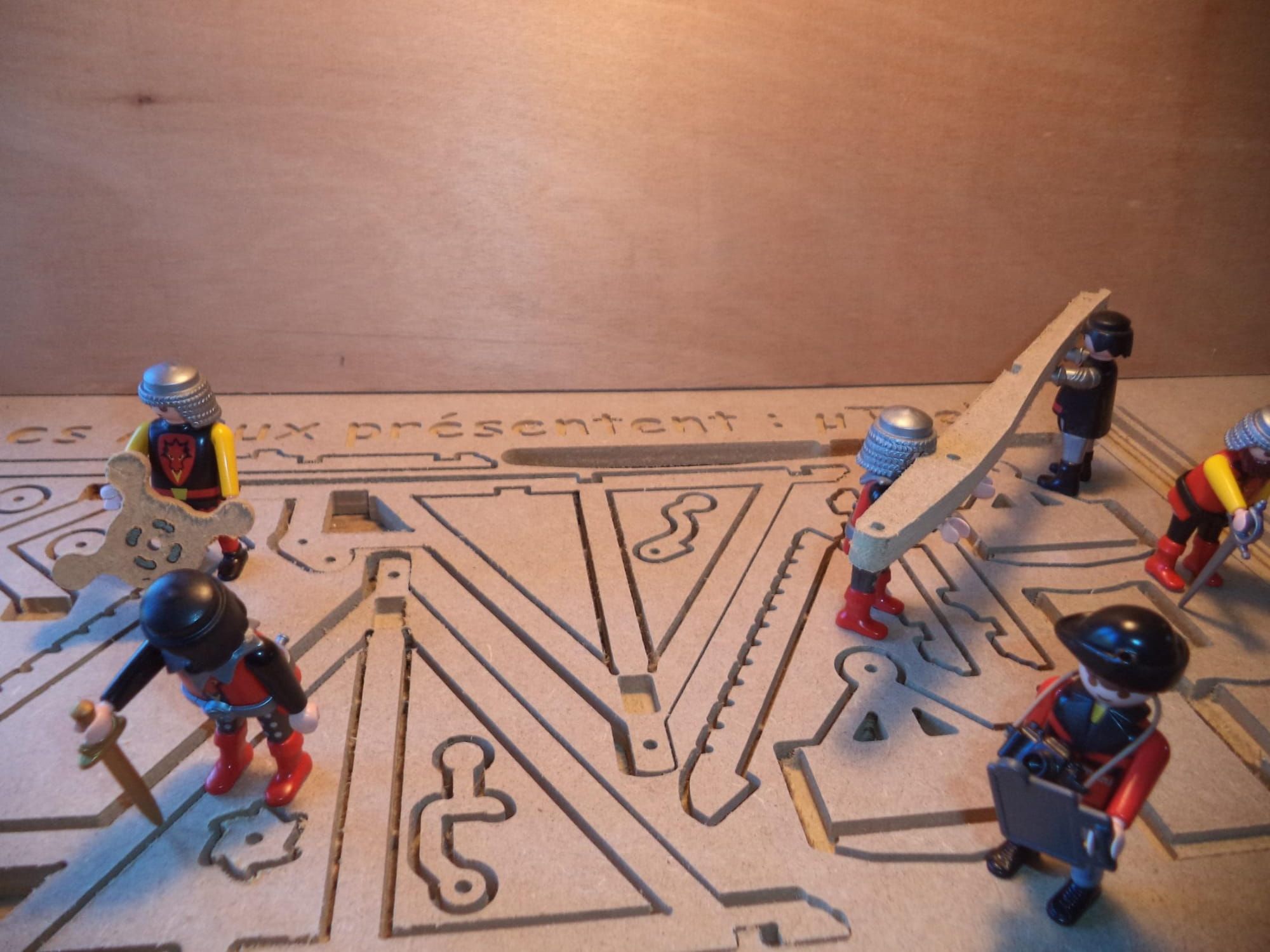

Step 2: Machining

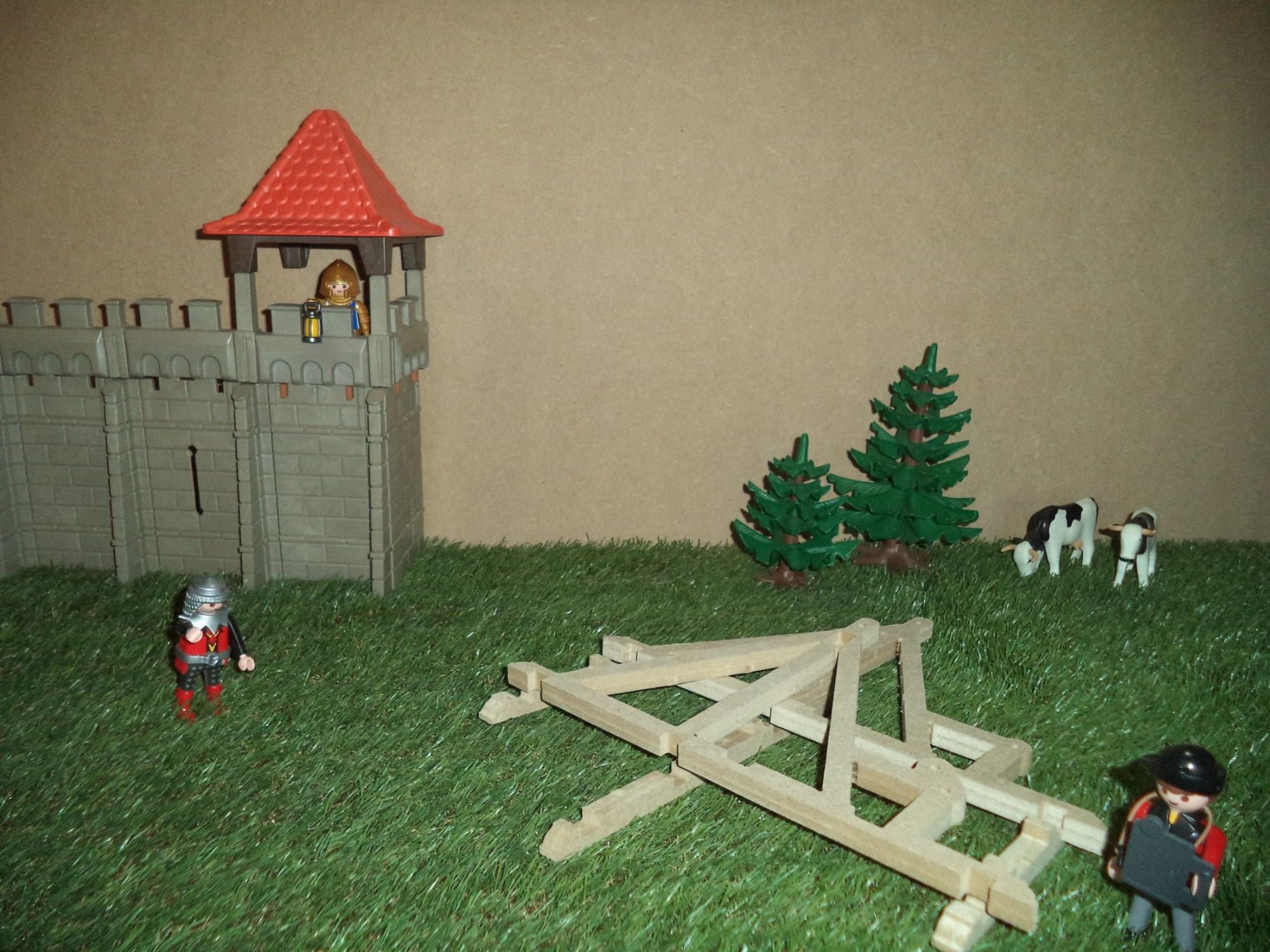

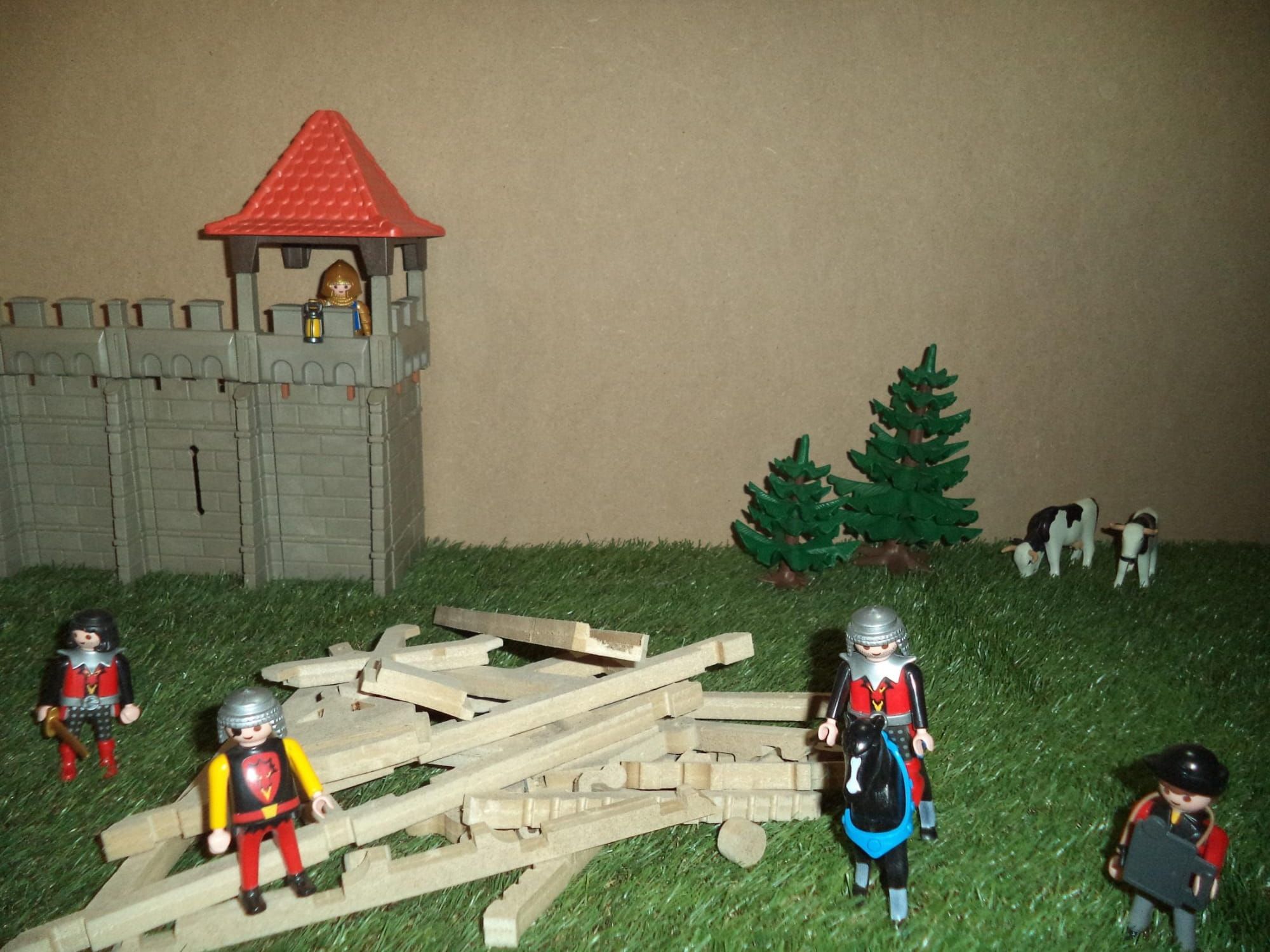

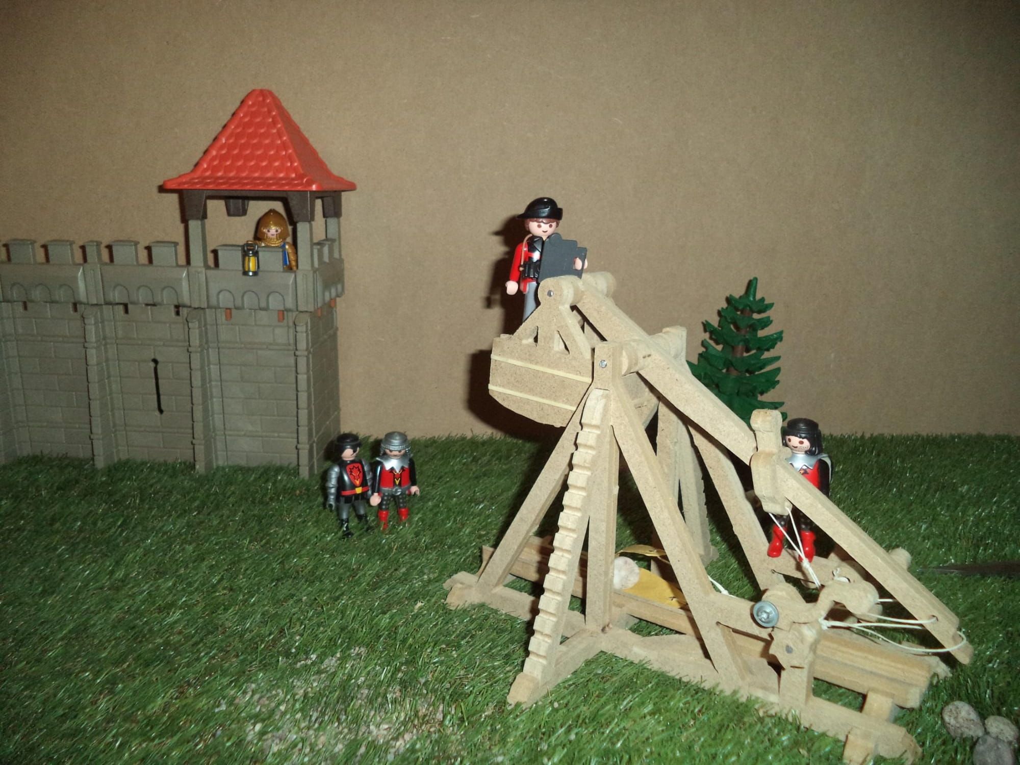

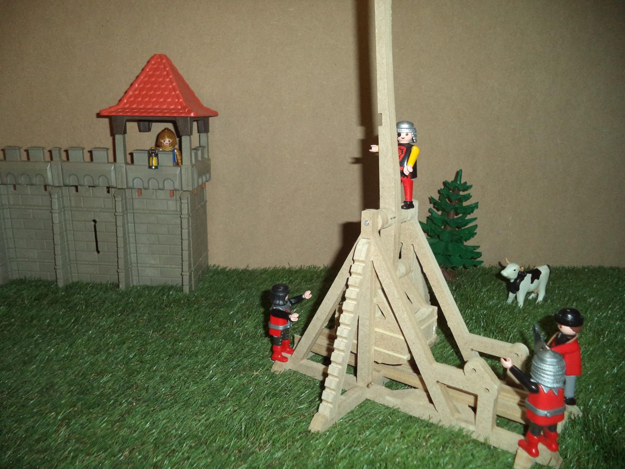

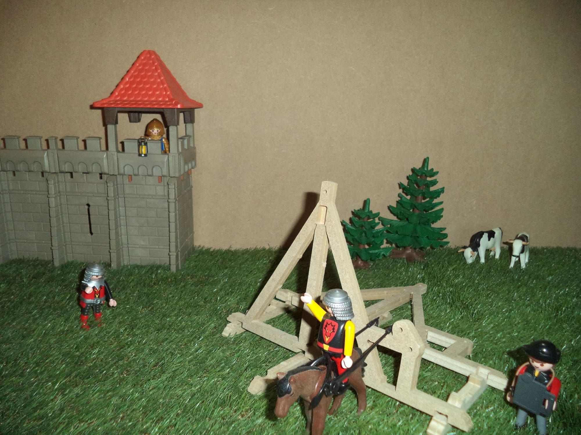

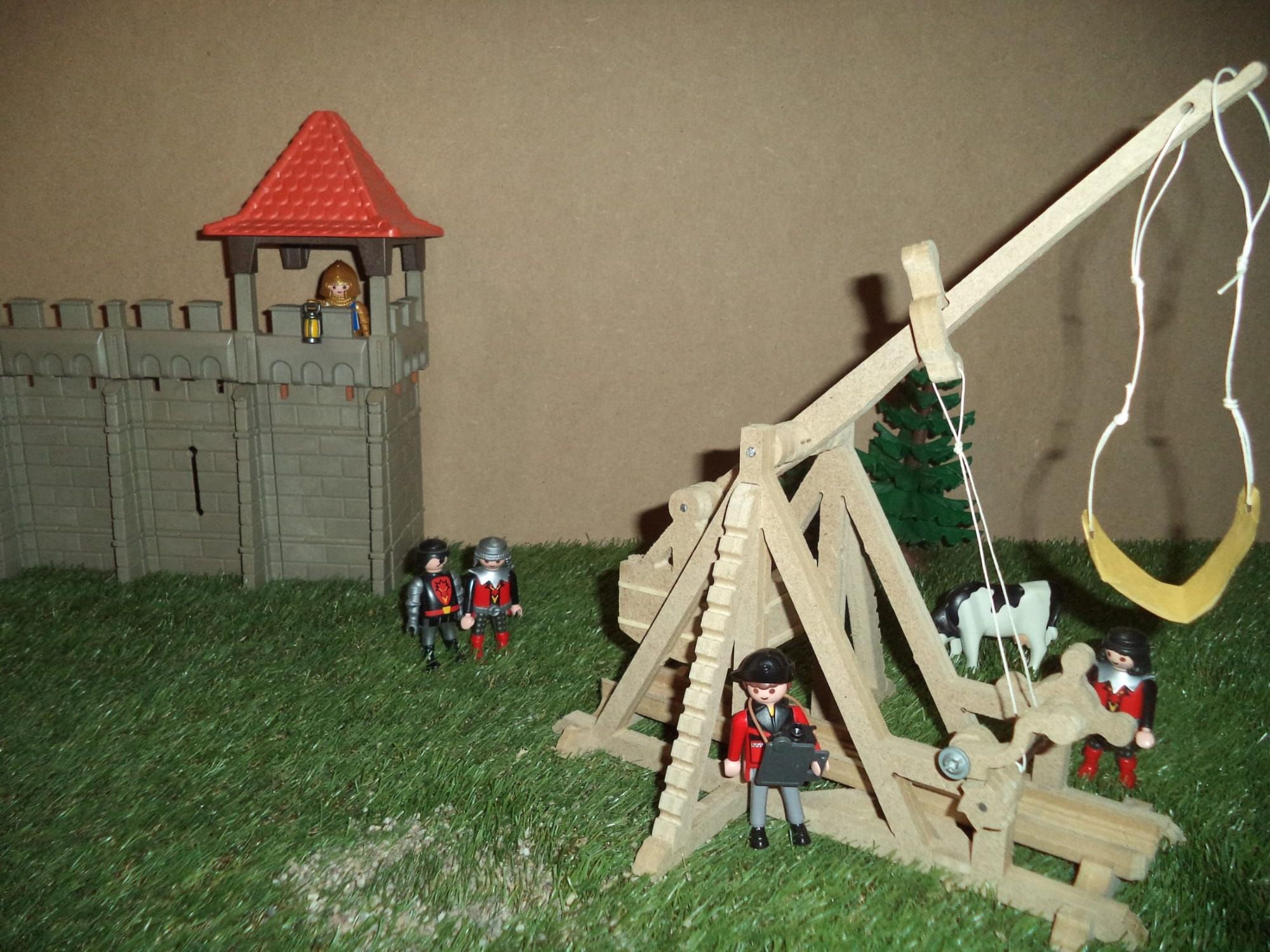

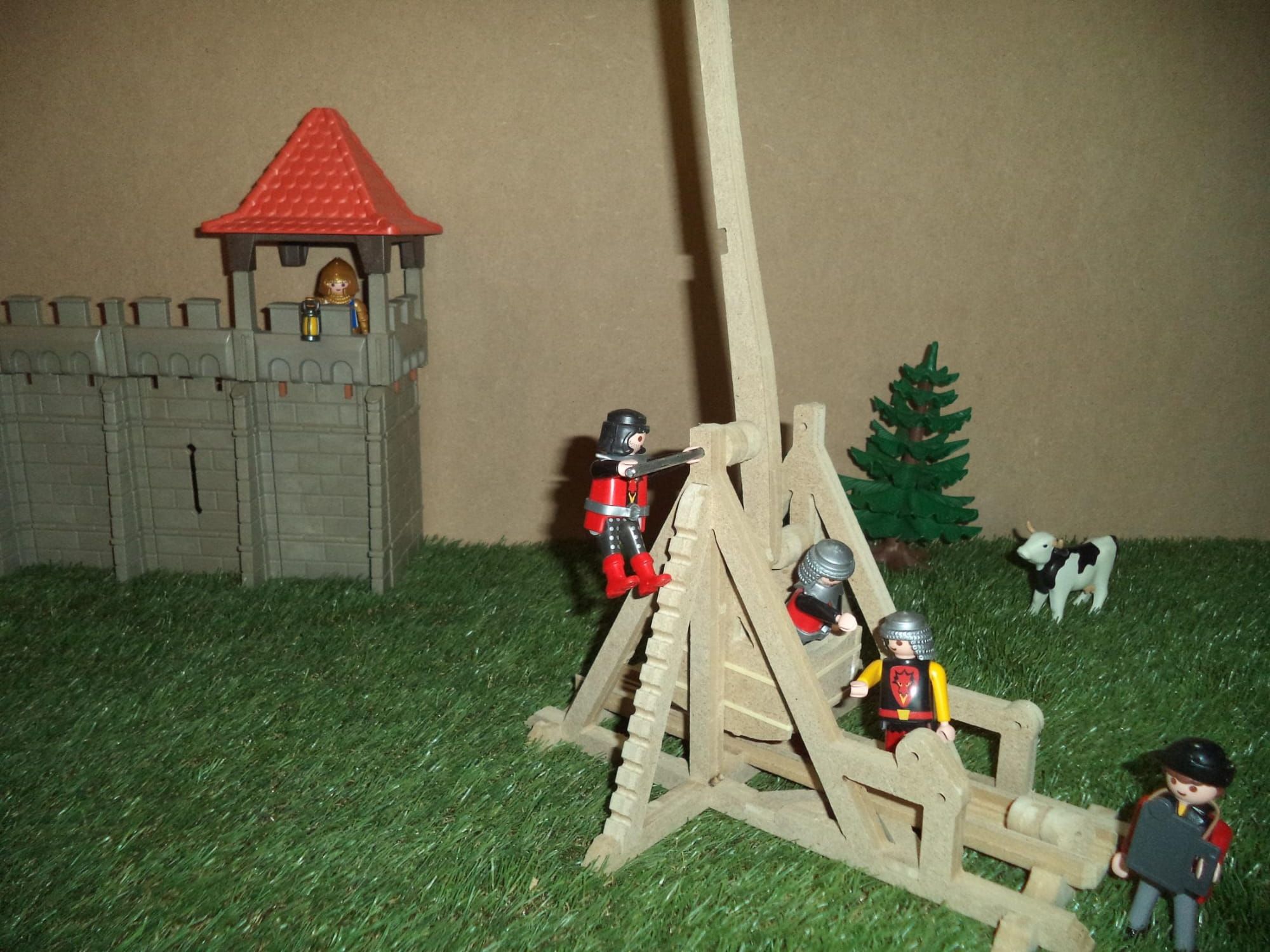

![]() | First, you need to take out the plank all the parts using a cutter if you make clip while machining. |

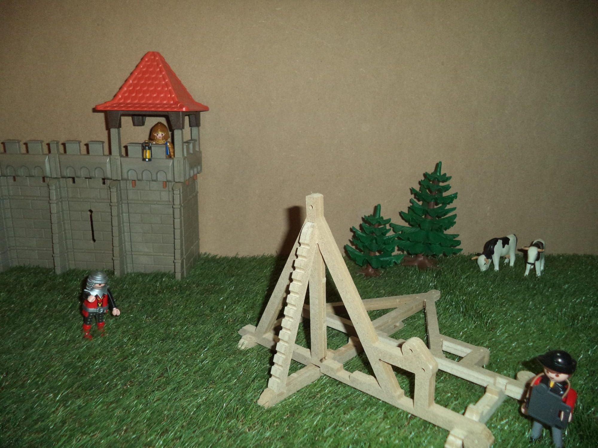

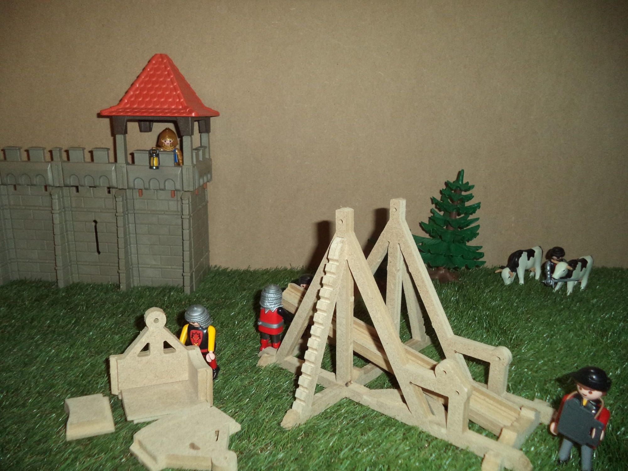

Like our little friends, set the parts 1, 1 and 3. | ![]() |

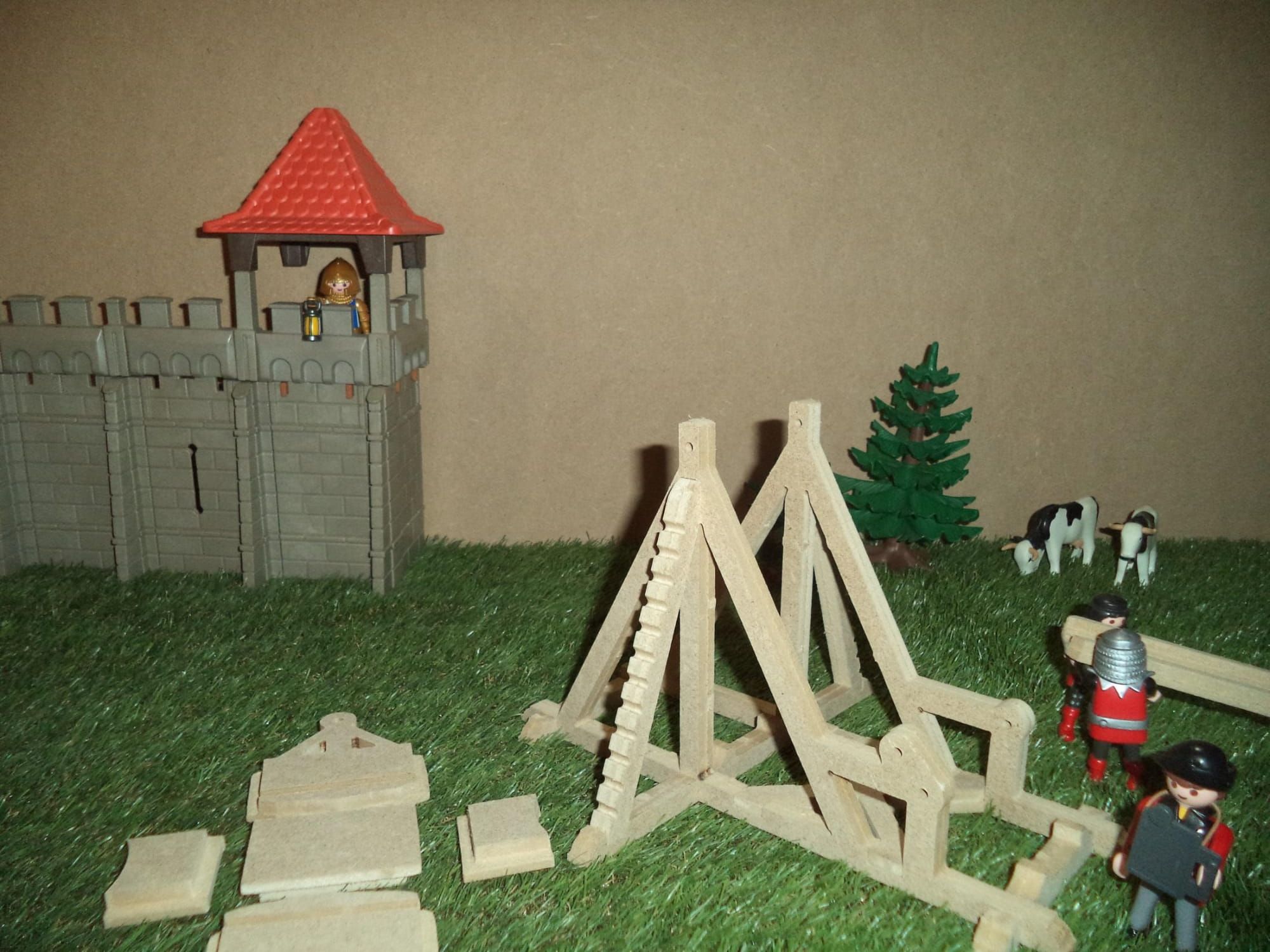

![]() | Set now the parts 3 and 4. They are a little bit different, be careful to put the right in the right place. |
Use wood glue and fix one of the parts 3 and 4. | ![]() |

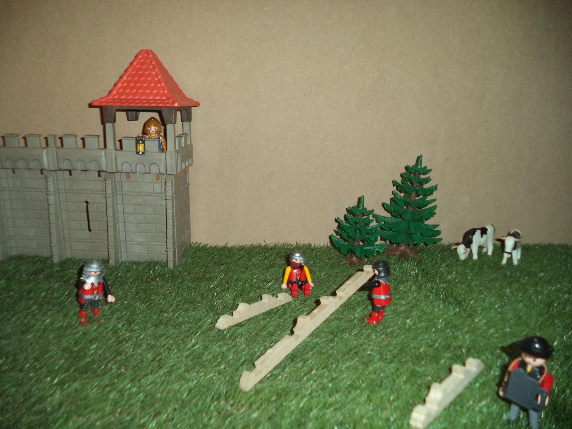

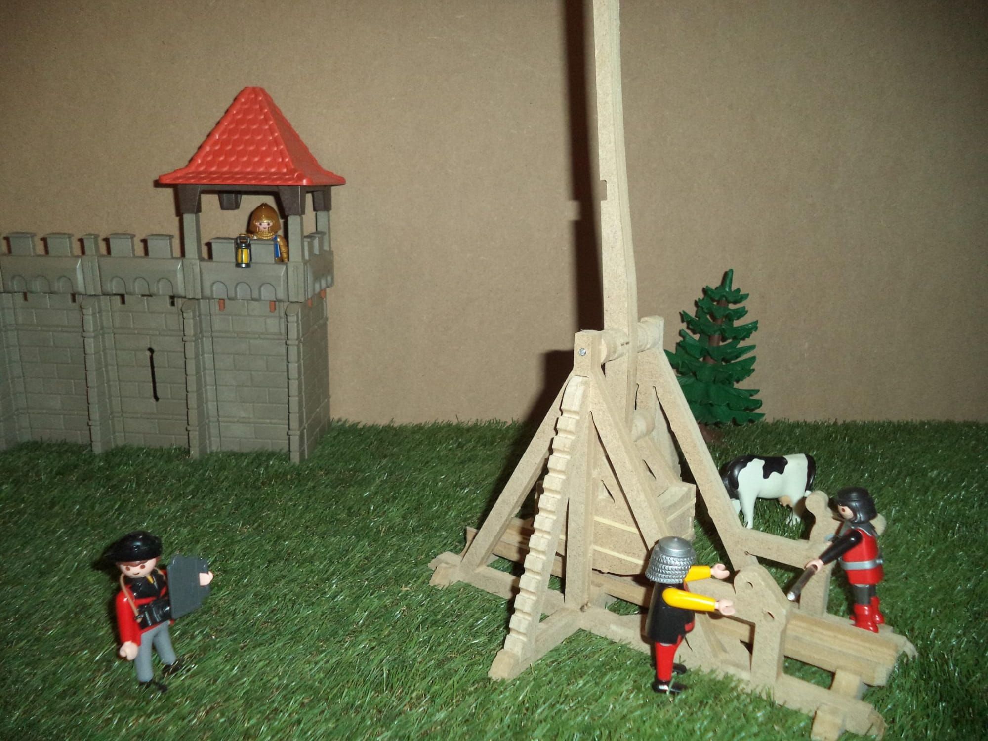

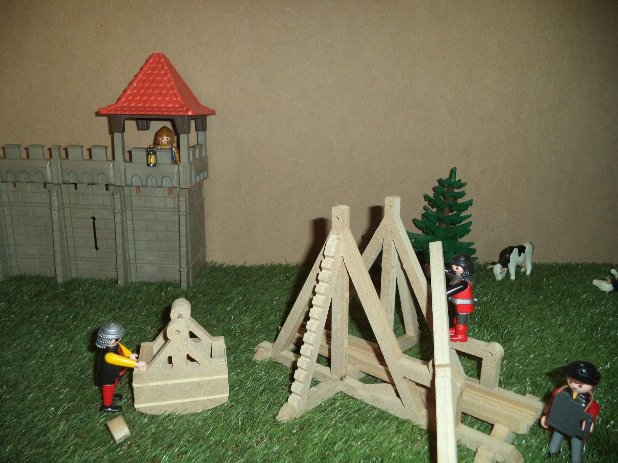

![]() | Glue now the ladder (part 5) |
Do the same thing with the other part (3 or 4) and with the other ladder (part 5). | ![]() |
![]() | Glue the x part number 6. |

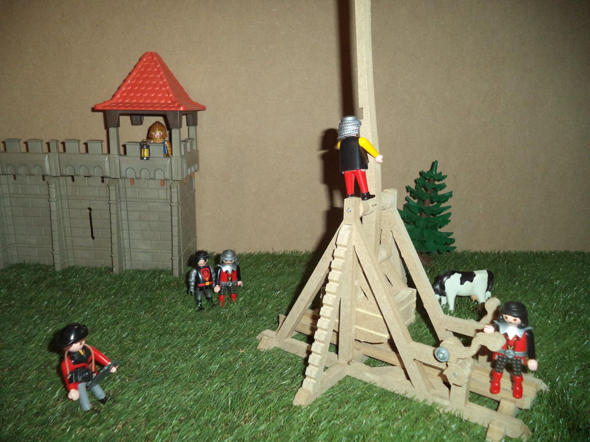

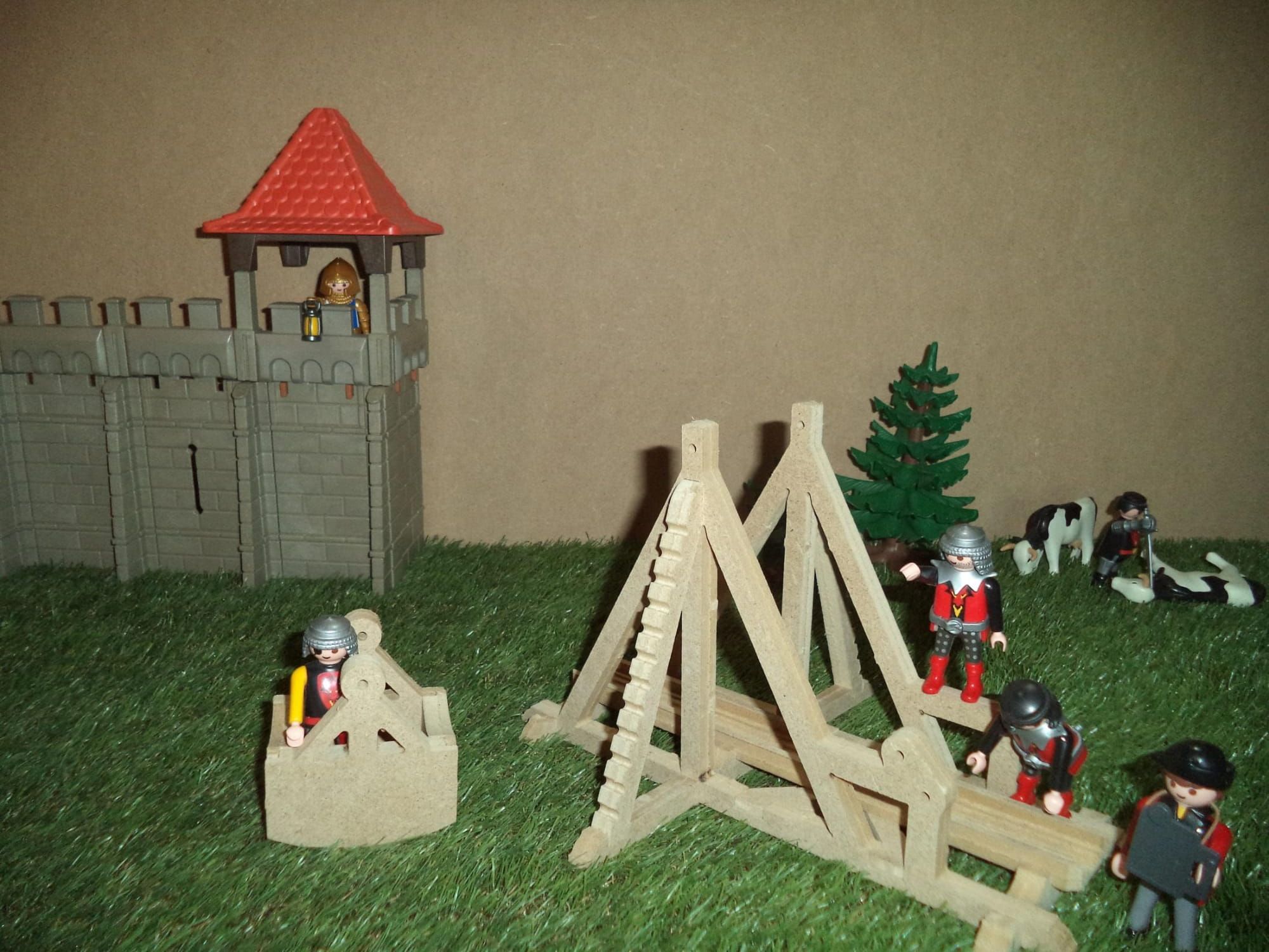

Now the little men will build the counter weight. You need the parts 7, 8, 8, 9 and 9. | ![]() |
![]() | Glue all the parts and use some elastics. |
Wait for the glue to dry. Set the chute (part 10). | ![]() |

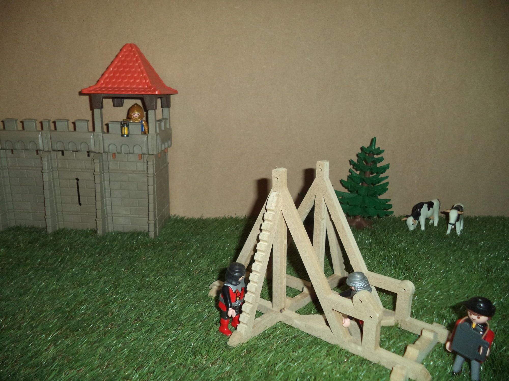

Fix the counter weight using the 55 mm brass rod to the part 11. | |
![]() | Fix the part 11 to the rest of the trebuchet using the 80 brass rod and four part 12. |
Glue the axes | ![]() |

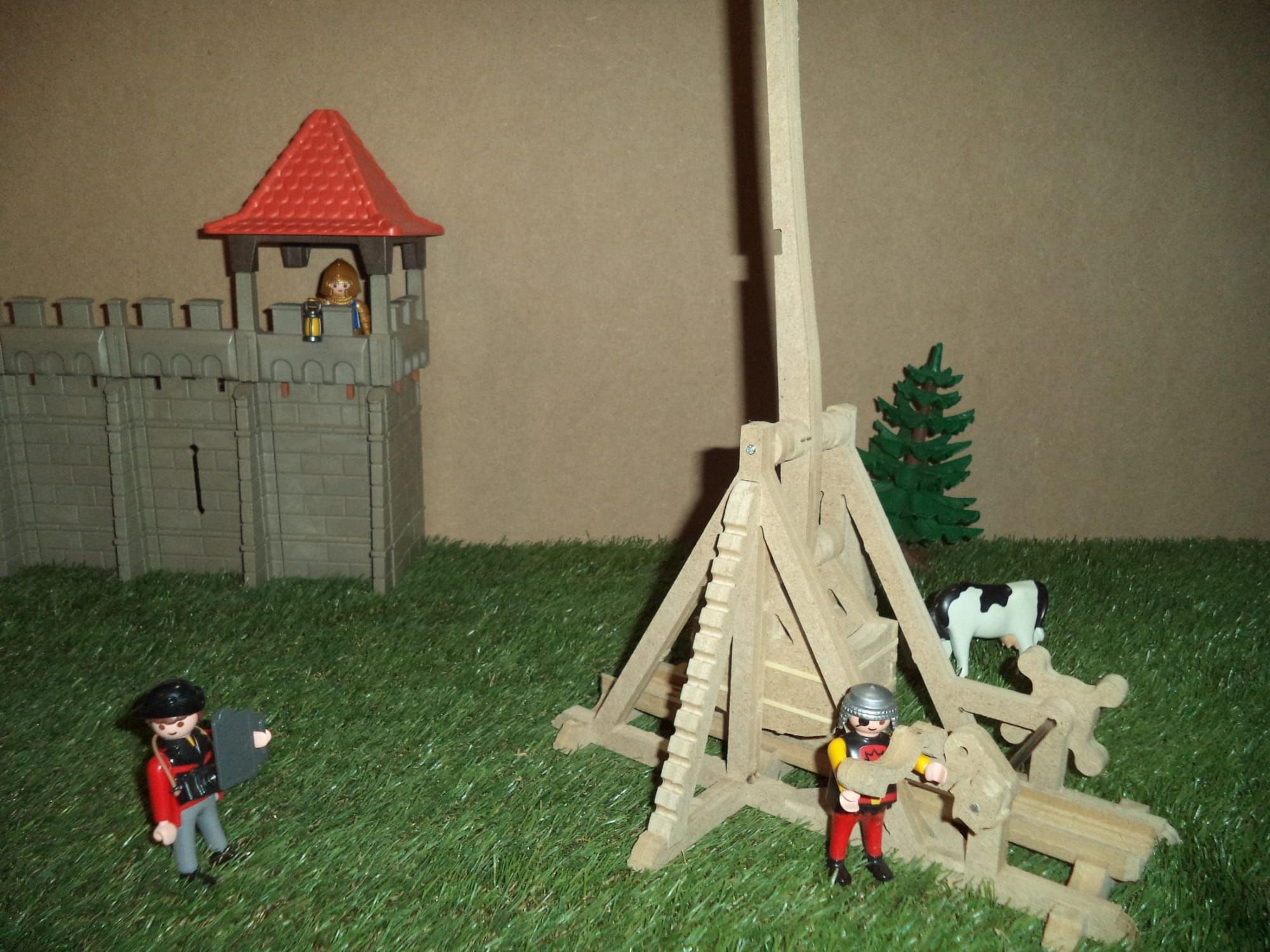

![]() | Put the 105 mm brass rod like our little friends. |

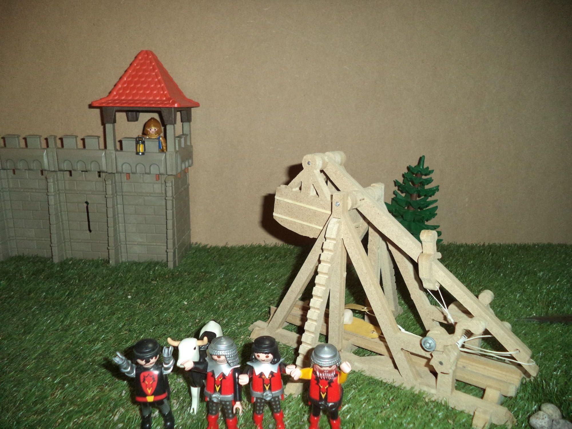

Set and glue on the axe the parts 14 and 13. | ![]() |
![]() | Use a 4mm diameter screw to fix the part 16. |

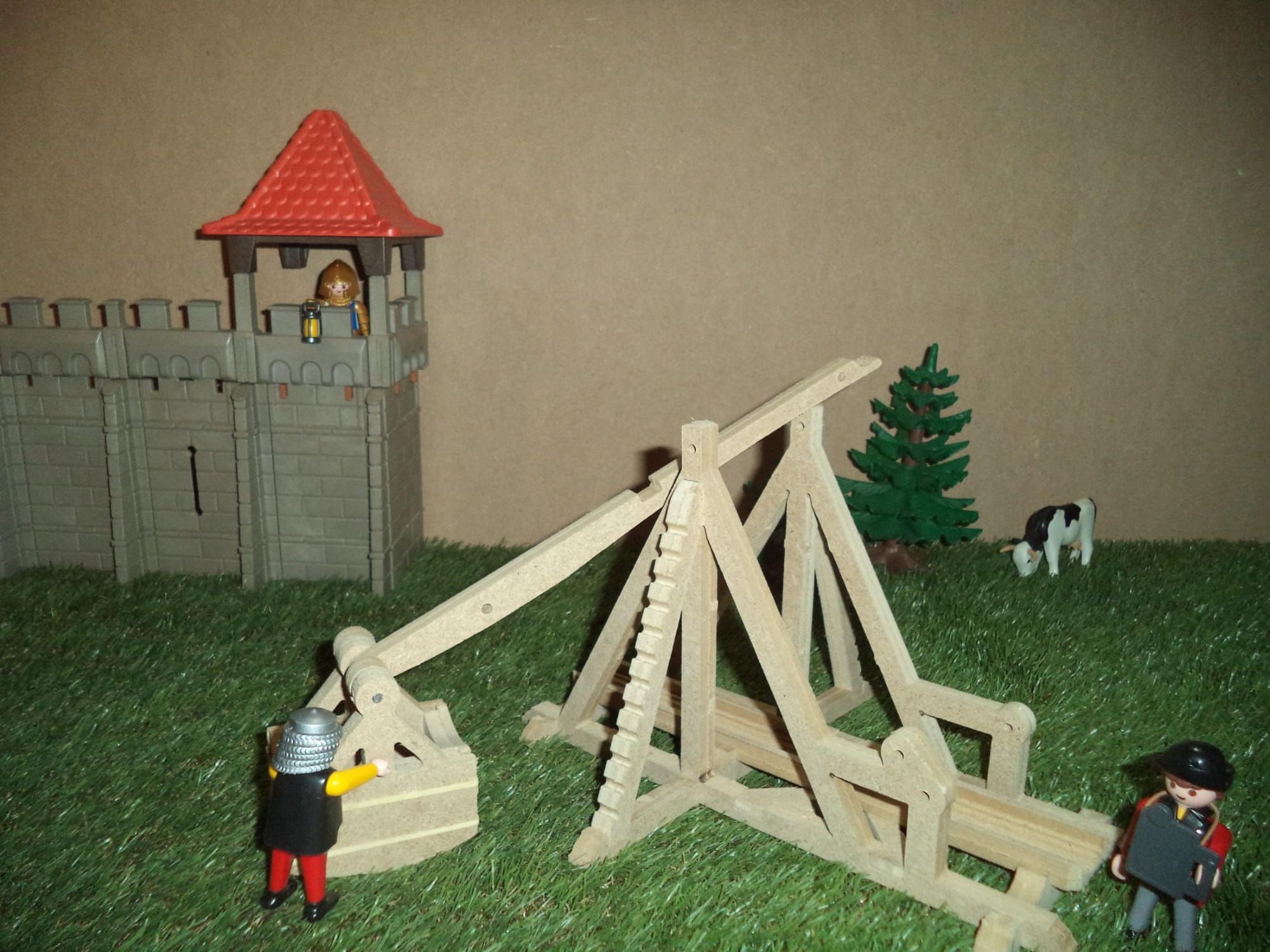

Fill the counter weight with sand | ![]() |
Fix the sling with rop and the part 16. | |
Finish ! You are ready to attack a castle ! |
