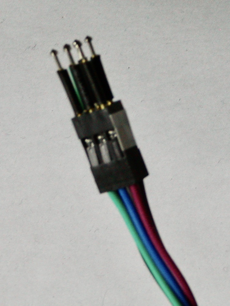

Connect a 6 pin ISP cable from the ICSP header on the board to the connector on a 5V ISP. I use an ISP cable with pogo pins on one end so that the 6 pin ICSP header doesn’t have to be soldered onto the board.
The connector with pogo pins are held in place when needed.

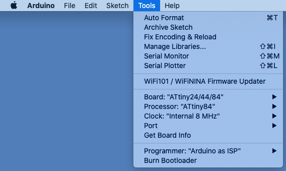

The MCU used on the boards is an ATtiny84A. In order to use this MCU you need to add "https://raw.githubusercontent.com/damellis/attiny/ide-1.6.x-boards-manager/package_damellis_attiny_index.json" to the "Additional Board Manager URLs" section of the Arduino Preferences dialog. This is only done once.
Once installed, set the Arduino settings as:
(The screenshot doesn't have a port selected. Select the port used by your ISP.)
Using the same setup as the previous step, use the Arduino IDE to upload the DCSensor sketch via the ISP.

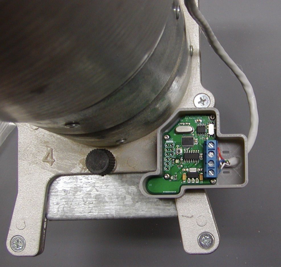

The sensor needs 6.5 to 12 volts to operate. The sensors are wired in a daisy chain configuration. The board’s termination switch setting for all sensors in the chain should be set to “Middle” except for the last sensor in the chain. The last sensor is set to “End”. The wire I use is ordinary twisted pair Cat5e cable. Assign one pair as ground, one as +12V, and the last two pair as CANL/H in and CANL/H out. You could also run two Cat5e cables to each sensor, one for IN and one for OUT, but I chose to limit the number of cables running up and down the dust collector pipe by adding a junction at the top of each pipe.
The easiest way to make the board connections is to run a length of wire through the strain relief hole on the sensor case. With the board removed from the case, make the connections. Then mount the board in the case and add a wire tie to secure the cable. Run the length of wire up the pipe to the junction at the top of the pipe. At some point I’ll publish the 3D printed junction box and cable tie mounts. The case is attached to the blast gate using double sided foam tape. 3M sells a very aggressive double sided foam tape pre cut into 25mmx25mm squares. Position and attach the magnet on the gate slide under the Hall sensor using double stick tape.
These squares can also be used to attach the junction box and cable tie mounts.

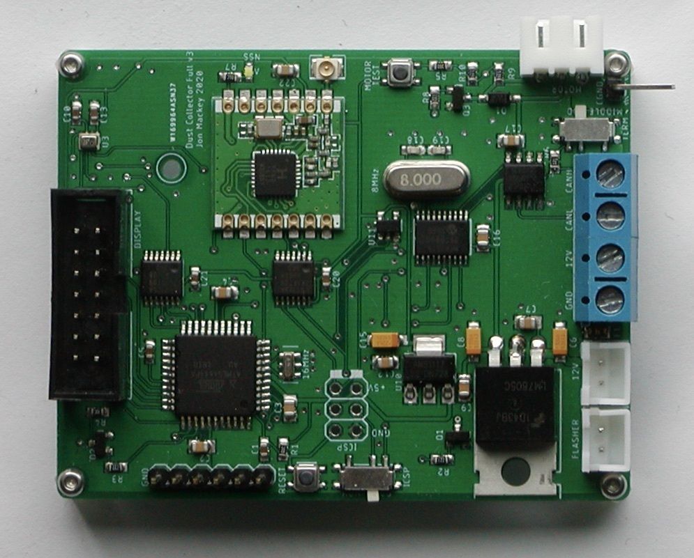

So that’s it. I hope to publish the dust collector controller by the end of the year. (I need to make a few changes to the board.)
Dust Collector Controller board v3.0
