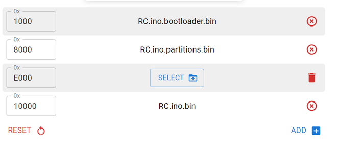

Step 2: Prepare ESP32
Flash the ESP32 with the .bin files found at the SRI Github using the following tool and instructions:
https://blog.spacehuhn.com/espwebtool#heading-esp-web-tool
https://esp.huhn.me/
Use the following Memory Assignments:
0x1000 RC.ino.bootloader.bin
0x8000 RC.ino.partitions.bin
0x10000 RC.ino.bin
Rally Controller Firmware .bin(s):
https://github.com/StylesRallyIndustries/RallyController/releases/tag/Public
Confirm this has worked by using Bluetooth on your device to connect to the Controller 'RCntrl P.1' while the ESP32 is connected to your PC.
Optional: Visit the SRI Githubfor the latest software version and additional information.

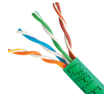

Measure and cut the length of network cable required (from controller position on left grip to intended CU mount point) and expose wires on one end.
Prepare the network cable and 4 twisted pairs of wires:
Protect connections with heat shrink.
  • 4 solid colour (Brown, Green, Blue, Orange)
  • 4 with matching colour and white stripes.
Using matching colours solder a Dupont female header / jumper wire to each of the solid colour network wires.
Using a solderless connector join the remaining 4 striped wires to 1 Black wire header for ground.
Feed the cut end of the network cable through the control cable hole on the CU, then through the hole on the Controller.

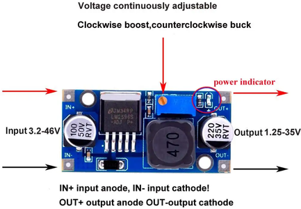

Insert the 12v INPUT lines from your power source into the marked hole, and solder to the appropriate INPUT connections.
Solder wires from power button (if using) to appropriate INPUT terminals on converter.
Important: When using the adjustable Step Down converter you will need to ensure the output is set to ~5v with a multimeter.
Solder Dupont female headers to the OUTPUT terminals on the convertor.

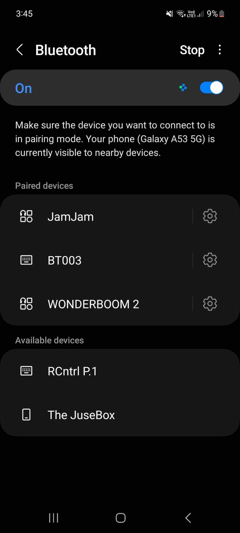

Initial set up:

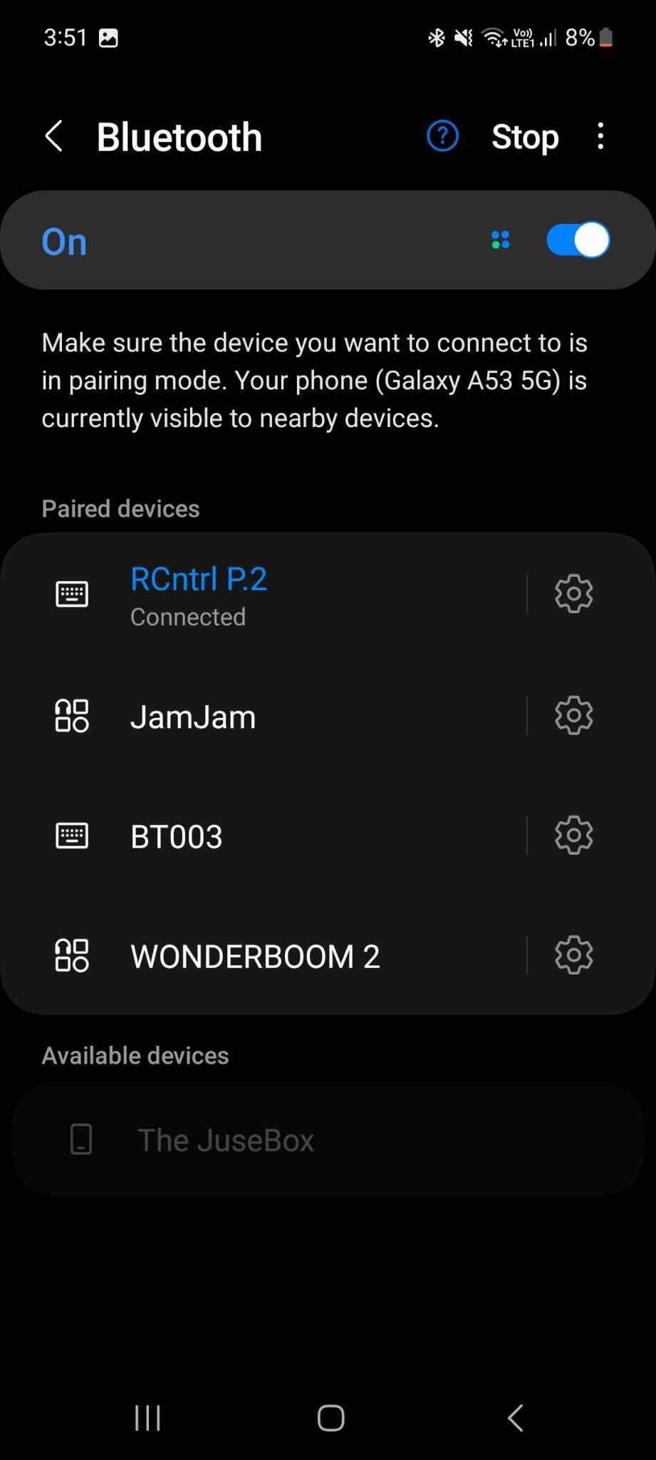

Once powered you can pair your phone or device to the controller.
When in range your phone will automatically connect to the powered controller.
Toggling Profiles:
Hold down the Top and Bottom buttons for ~5 seconds to toggle between profiles.
You can confirm which profile is selected by pressing 'scan' on the Bluetooth connection screen on your phone.
The controller will return to Profile 1 when powered off and on.

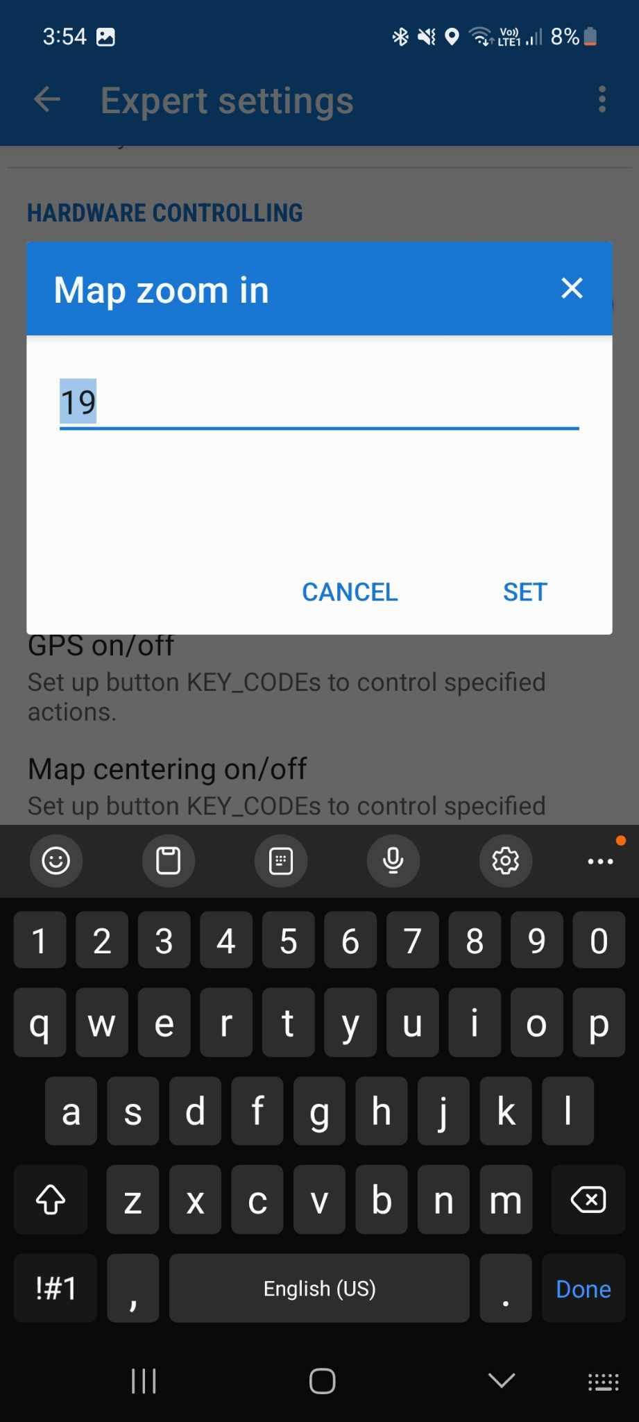

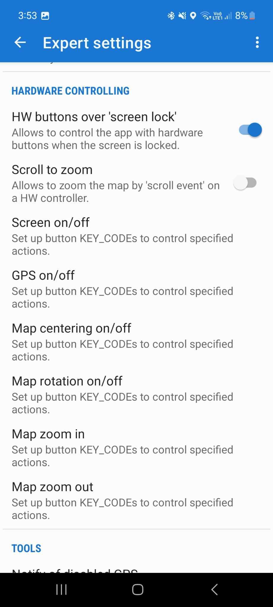

Locus maps requires you to change the expected keys to match the constant values as listed.
Activate Expert Mode:
Long press on the Locus main menu button (3 horizontal lines, top left) and tap Expert settings.
Settings -> Expert Settings -> Hardware Controlling
  • Button 1 - Map Zoom In (Constant Value: 70)
  • Button 2 - Map Zoom Out (Constant Value: 69)
  • Button 3 - Map Rotate / Fixed North (Constant Value: 46)
  • Button 4 - Map Centre on Current Location (Constant Value: 31)
