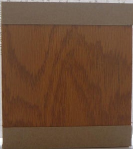

Step 2: Make the Bookends
Skip this step if you have existing bookends that you want to add a calendar to. See the pdf file “Construction Details” for suggestions on how to do this.
The first thing to do is to cut the 5/8 or 3/4-inch material to size. Two pieces, each 5 1/4 inches high by 4 3/4 inches wide are required. I made the height the same as commercial bookends that I have had for years. The width is what is needed for a calendar that is easy to read. My commercial bookends are 4 1/4 inches wide. I could have made the width this size, but I happened to have a piece of 5/8-inch thick particle board that was 4 3/4 inches wide and decided to use it without cutting it down.
After the thick material is cut to size, prepare the two pieces for staining or painting. My particle board has a thin laminate with simulated wood grain on two sides and does not need further finishing on its sides. Ideally the two side and top edges that are seen should be covered with wood veneer that can be finished to look like the simulated wood grain. The edges can also be painted. To prepare for painting, sand the edges. If the edges have some pits after sanding, fill them with white glue or a mixture of white glue and sawdust and sand again. I was more interested in demonstrating how a perpetual calendar can be built into a bookend than making a good-looking project, so I left the edges unfinished.
Next, cut the hardboard tongues that the books sit on to size. Two pieces 3 5/8 inches by 4 3/4 inches are required. On my commercial bookends, there is three inches of tongue under the books. My end pieces are 5/8 inch thick, so I made the tongues 3 5/8 inches long. The width of the tongues is the same as the end pieces, which is 4 3/4 inches. The ideal thickness for the tongues is 1/8-inch. However, 1/4-inch material can be used if a thinner material is not available. The tongues are not seen when there are books on them so there is no need to find a material that looks like the ends.
If the ends are going to be finished differently than the tongues, I suggest finishing them separately before assembly. For good looking bookends, the ends could be stained plywood and the tongues painted hardboard.
The first step in attaching a tongue to an end is to glue it. This is to hold the two pieces together before the screws are put in. After the glue is set, use two #4 by 1-inch screws on each tongue to make a strong joint. Locate each screw one inch from the end. Drill a 3/32-inch diameter by one-inch-deep pilot hole. Then remove material for countersinking so that the head of the screw is flush with the bottom surface of the tongue. This is a bit of a delicate operation. Enough material has to be removed so the head will be sunk far enough, but enough material has to be left so there is sufficient tongue material under the screw for a strong joint. I held a 1/4-inch bit in my hand and removed material with it.

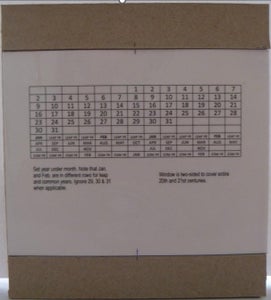

Step 3: Make the Calendar
The first step is to print the pattern on 60 lb cardstock. Then use a small flathead screwdriver to make a score mark on the dashed line between the two sides of the window. The extra material on the right side and below the two parts is used to make part of the track that the window slides in. Draw a line one inch to the right of the pattern and a line one inch below the pattern to mark out the strips that will be used for the track.
After the fold line is scored and the lines are drawn, cover the sheet with a self-adhesive laminating sheet. This strengthens the 60 lb cardstock and makes the window easy to slide. The laminating sheet can be eliminated by using thicker cardstock that has a glossy finish.
Use a utility knife and a straight edge to cut out the outlines of the two pieces and the two strips that will be part of the track. Do the cutting of the strips so that two strips one inch wide by 4 3/4 inches long can be made. A metal straight edge is preferred. Plastic will work, but it is more easily damaged if the utility knife slips. Put an old magazine under the cardstock before cutting. Self-healing cutting mats are available, but I have found that an old magazine works quite well. After the outline of the moving window is cut out, fold over the righthand side of the window and glue it to the back side of the lefthand side. Be sure to apply glue to the fold area, the outside edges and where the edges of the window will be after it is cut out. When the glue has set, cut out the window.
The above procedure results in an open window, which I recommend. Alternatively, the window can be two thicknesses of laminate. This is achieved by applying laminate to each side after the window is cut out. The resulting window has many imperfections when held up to a light, but they do not show when it is in place. When the window is laminate instead of open, the moving window assembly is more rigid. However, the rigidity is adequate when the window is open.
Step 4: Make the Track and Attach the Calendar to One Bookend
The window slides in a bottom track and a top track. Each track has a spacer that is slightly thicker than three thicknesses of 60 lb cardstock plus three thicknesses of laminate. I found that two layers of a cereal box is thick enough for a spacer. To make the spacers, glue two strips together that are about 1 1/2 inches wide by 11 inches long. Make sure that the glue covers one surface well. After the glue has set, mark out a strip in the middle that is 3/4 inches wide by 11 inches long. This will leave about 3/8 inches of waste on each side. Cut out the 3/4-inch strip and then cut it into two pieces that are each the width of the bookends, which is 4 3/4 inches. To cut through two layers of cereal box, two or three passes may be required. Once the first pass is made, following the same line to cut deeper is not difficult. The spacers can be made by gluing single layer strips together after cutting to width, but making sure the edges line up to make a smooth track may be difficult.
Glue one spacer to the bottom of the bookend covering up the end of the tongue, and glue the other strip to the top of the bookend. Put a mark in the centre of each spacer. Check if the stationary part of the calendar (which has the day-of-month and month tables) will fit between the two spacers. Trim the top edge if the stationary part is higher than the distance between the spacers. Line up the centre marks on the stationary part with the centre marks on the spacers, and mark out how much has to be cut off each end to make the stationary part the same width as the bookend. Cut the stationary part to width and glue it to the bookend. Three half-inch wide strips of glue are sufficient. Apply a strip of glue to the back of each side edge and a vertical strip in the middle. There is no need to apply any glue to the back of the top and bottom edges. The stationary part has to fit tightly against the bottom spacer for the calendar to display properly in the window. There can be a slight gap between it and the top spacer.
The one-inch-wide strips mentioned above are guides that hold the window in place as it moves along the track. Glue one strip on top of the bottom spacer and one strip on top of the top spacer. Apply the glue to the spacer and take care that no glue gets on the edge where the window makes contact when it slides.
The final step is to install the window. Trim the top edge of the window if it is higher that the distance between the spacers. For smooth movement of the window, there needs to be a 1/16-to-1/8-inch gap between it and the top spacer. Slide the window into the tracks with the century of interest showing.
Step 5: Using and Understanding Your Calendar
The left-hand instructions on the calendar, which are always partially covered by the window, simply say: “Set year under month. Note that Jan. and Feb. are in different rows for leap and common years. Ignore 29, 30 and 31 when applicable.”
The right-hand instructions, which are also always partially covered, say: “Window is two-sided to cover entire 20th and 21st centuries.”
In the month table on the stationary part, the top row applies to January and February of a leap year, the middle two rows apply to March to December of all years, and the bottom row applies to January and February of a common year. To bring attention to leap years, JAN and FEB are in bold in the top row and leap years are also in bold in the year table. The calendar always displays 31 days for the month, with 29, 30 and 31 to be ignored when applicable.
If you imagine that the columns in the year table are labeled Sunday to Saturday from left to right, common years are under the day of the week that January 1 falls on and leap years are under the day of the week after the day that January 1 falls on. In the month table, the months are in columns that the day of the week that the first of the month falls on relative to the day of the week that the first of January falls on.
