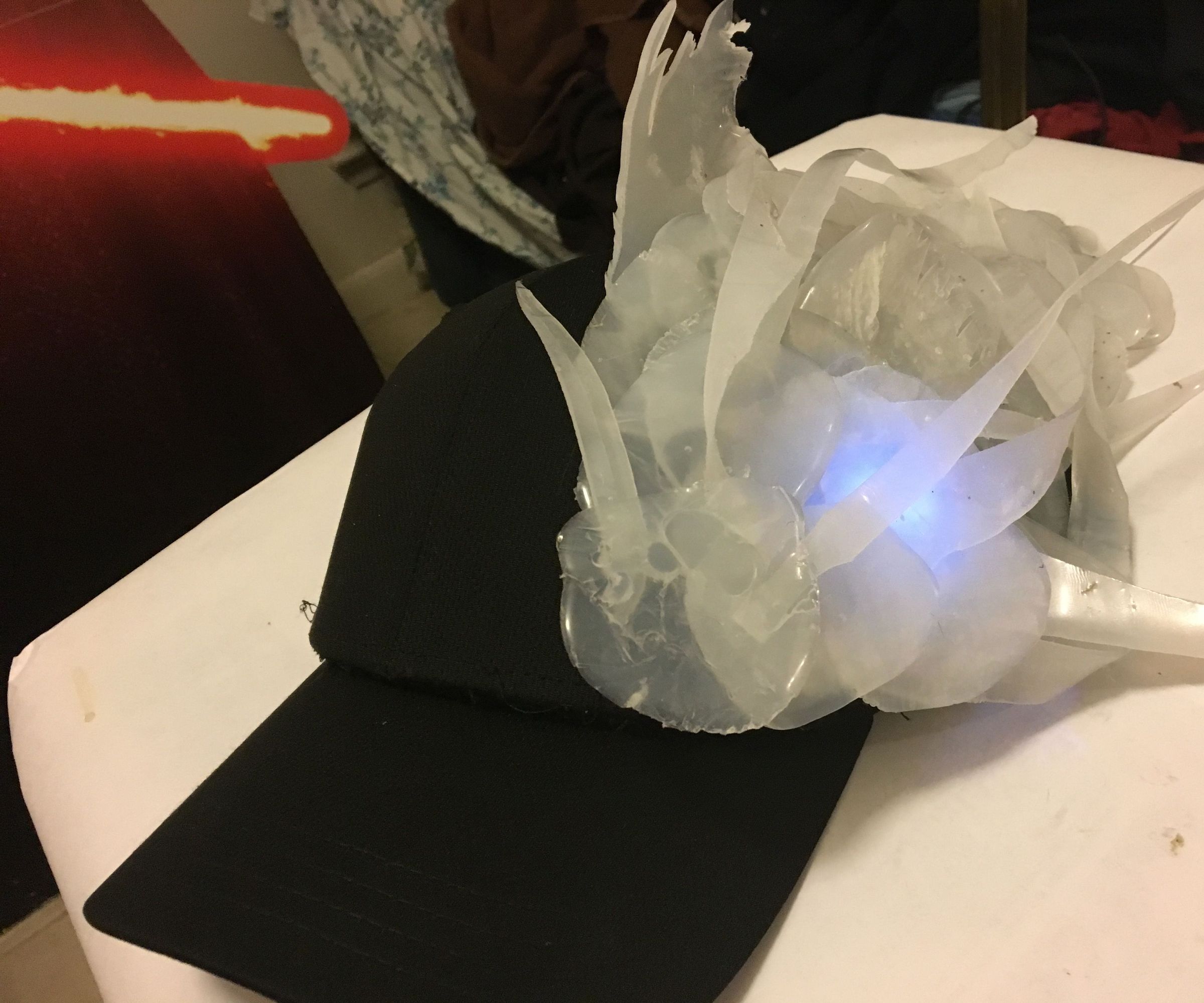

Introduction: Bright Cap
The wearable we are going to make today is a motion-responsive glowing hat. A simple accessory that will let you stand out in almost any situation. The end goal is a hat that reacts when someone passes in front of it. The parts we will need are as follows:

Step 3: The Hat
What I did here was to purchase two nearly identical hats. one slightly larger than the other. Using the seam ripper. I carefully split the front down the middle where the seams connected. Also removing and discarding the brim. Turning our attention to what will be the inner hat, we begin attaching the circuit. The Arduino and the sensor have holes that make this part easier. The LEDs you must take care to arrange them to were the are evenly spread. I used three different colors, so I also make certain that they were arranged so that the colors were adequately dispersed. Next you will want to put the top hat over the bottom. size up haw much room you will need to attach the top. I used the edge of the brim as a guide, with the open front of the top meant to attach at the edges of the brim. Then I measured, cut, and sewed the transparent fabric to the opening. Next cut a hole for the sensor to poke through, and sewed the sensor into place so that it wouldn't move. now you simply fit the top onto the bottom and sew the two halves together.
