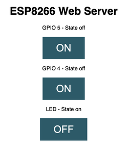

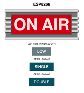

The sketch in this repository acts as a webserver with static links for three operations: 1) toggle the built-in LED, 2) send a 0.10-second "tap" to the switch, and 3) send two 0.10-second taps, 0.10 second apart. This way we can go straight to fully-on (1 tap) or pulse operation (2 taps).
- Connect the board to a laptop or PC running the Arduino IDE. For the ESP-01S, there are dedicated USB dongles, or you can do it using the more rustic approach shown here. There's a good general Instructable that covers several options.
- Upload the SVG image to the ESP-01S using LittleFS, a filesystem for the on-board flash memory.
- Upload the sketch to the ESP-01S

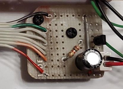

We'll emulate the switch with an NPN transistor. The implementation above is from Bill Traynor and the CE Linux Forum's GPIO control reference. The 5v and 3v power supplies share a ground. It can be set up for testing using an LED wired from the 5v power rail in place of the switch input. Since the GPIO pins on the ESP-01S need to be held high to get it to boot without going into programming mode, we use the RX pin as a GPIO for the switch. (Note that this means we'll have to remove the module if we want to upgrade or reprogram it later.)
Step 5: Solder Up the Control Circuit
This whole thing could be assembled on one board, but given the low cost of the components and my personal tendency to go back and fiddle with things, a modular approach seemed better. In this case, JST connectors are used for the 3v and 5v power (incompatible, so that they won't be mixed up), and an 8-pin header and ribbon cable are used for the EPS-01S board. The switching circuit is implemented on a small piece of philmore-style protoboard.

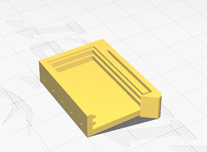

The LM2596 buck module and the protoboard have mounting holes, so epoxying a few standoffs to the back panel works well. They could also be hot-glued in place or mounted in another way.
The ESP-01S has no holes, and is a pretty compact board without room to drill, so I created a small glue-down mounting bracket that can be 3D printed. It can be found here on Thingiverse.

There is a lot of room for improvement here. There are better, more complete HTTP servers for the ESP8266, the SVG does not center properly on a mobile browser, and it would be nice to add a feedback mechanism to be able to see the current state of the LED driver.
One easy improvement was to add the "API Request" plugin to my Stream Deck so that it can call the static links for single and double taps with custom buttons.
