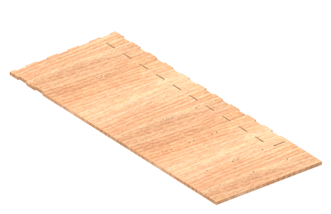

Lasercutting wood
For the base underneath the fridge a lot of 6mm panels, as well as some 3mm panels, have to be cut using the lasercutter. All 3D files can be found attached to this step.

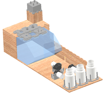

Step 6: Water Reservoir & Interface
Additiontal information for the bottom interface 3D print
The bottom part of the water reservoir interface has m3 nuts embedded inside it. In order to make this possible the print has to be paused at a certain height. Additionally, make sure supports are turned off for this print. A pause height of 5.6mm is recommended. When the print is paused, the nuts can be placed. Afterwards, the print can continue normally, embedding the nuts within the print.
To construct the water reservoir and its interface, the following parts will be needed:
Parts
- Jerrycan
- Pumps
- Top interface of the water reservoir (3D print)
- Bottom interface of the water reservoir with embedded m3 nuts! (3D print)
- Water supply interface (3D print)
- Sensors holder (3D print)
- Nutrients & pH fluids interface (3D print)
- Drainage pipe (3D print)
- Pump tube interface (3D print)
- m3 nuts and bolts
Cutting the jerrycan and drilling holes
A big square opening will have to be cut in the jerrycan. This opening will be 122x92 mm. The opening's 'bottom' is 74 mm away from the underside of the jerrycan. The opening's sides will both be 29 mm away from the sides of the jerrycan.
Additionally the top interface can be used to mark down the positions for the m3 bolts, so that they can be drilled. Note that the interface can be held in place by the corresponding holes in the wooden plate. The jerrycan will probably have a lot of give, so support it while you're drilling the holes.
Attaching the interface
When the opening is made and the holes are drilled, the water pumps, as well as the bottom part of the interface can be placed in the jerrycan. Make sure the tube of the waterpump passes through the correct hole on the top part of the interface.
When everything is prepared, simply pull up the bottom part of the interface to the opening, match it up with the top part and screw in a bolt. The bolt will automatically tighten as you turn it, because the nut in the bottom part can't turn. Repeat untill the the interface is safely and tightly secured.
Afterwards, the interfaces for the individual parts can be attached to the main interface.
