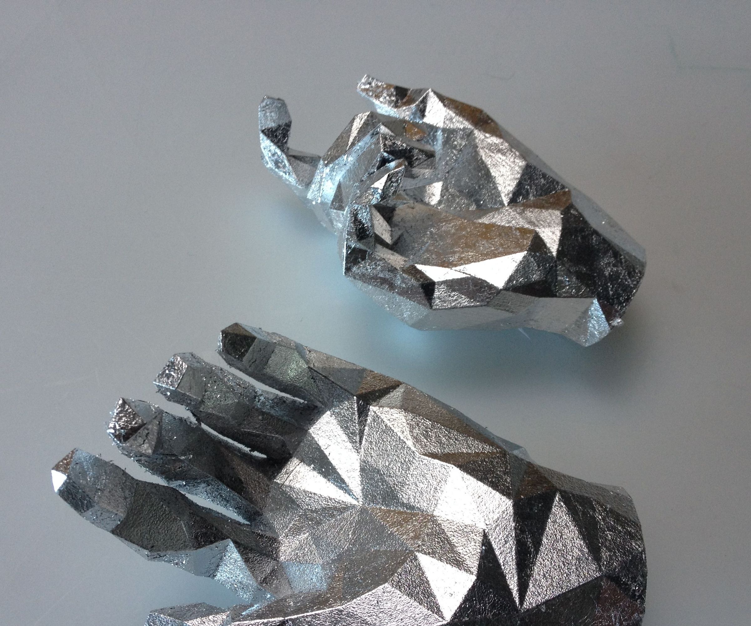

Step 3: Make a Small Pepakura Head...
Before I set out to make the big cardboard Gandhi, I tried a test to make a small head using standard laserprinter paper. I HIGHLY recommend you do this simply to get familiar with the basic process involved in constructing with the Pepakura diagrams.
The image here is of the first attempt at using the Pepakura process. As you can see, I reversed the process and kept the numbers and lines on the outside of the figure. The numbering and the lines generally go on the inside of the object ;-)
Pepakura uses a system of straight, unbroken lines for cuts, dotted lines and dot-dash-dot lines for valleys or mountains (can't remember which is which, read the tutorial with the software!).

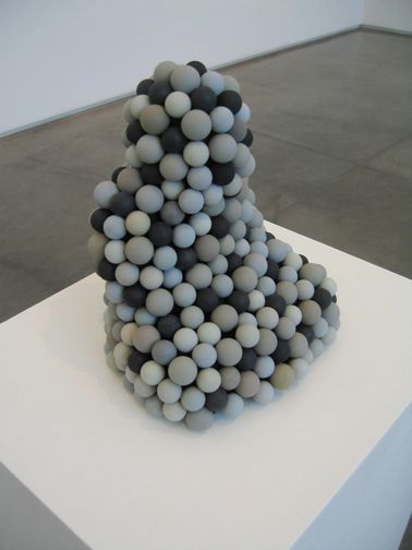

    The Gandhi sculpture is currently in a show at Eyebeam in NYC for the next week. I don't sell much work as I am not represented by a gallery. I am fortunate to have a university research and teaching position that allows me to explore creativity without the worry about selling my art.
    I've made a Buddha, a very small one, take a look at this.
    http://www.unr.edu/art/DELAPPE/Mouse/7_Stremmel_Show/7_Stremmel_Show_JPEGS.html
    The Gandhi work was inspired, in part, by seeing a huge Buddha at a gallery in London last year by a Chinese artist (his name escapes me). He made it out of the ashes of incense and it blew smoke! Very cool stuff.
    No giant Buddha in my future, not sure what I will do next.
    0
    inscrewtabunny
    inscrewtabunny
    Reply 12 years ago on Introduction
    Fantastic! You really captured the form with the balls, and the Mouse Mandala can't be blown away quite as easily as sand, thought provoking. I would love to see the ash Man smoking! The treadmill that allows you to walk in G.'s bare feet...! Funny. But this ball Buddha is lovely. Years ago I schemed to do a series of head stones for myself, but they were difficult to live with. Sleep with, headboard, chair back.
