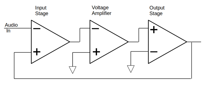

Before getting into the build, a little background theory. All audio power amplifiers follow a three block design, simplified in the diagram.
The input stage is a differential amplifier with global negative feedback from the output. The voltage amplifier is responsible for amplifying the signal from the input stage to a full voltage. The output stage primarily increases current to fully drive the speakers.

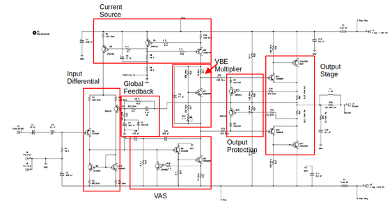

A more detailed block diagram shows all of the blocks that make up a class B amplifier. This topology is essentially the same as the amplifier in this project and is used exclusively in all discrete component audio amplifiers.
Here is the circuit diagram of the Randy Slone Design 3. The output stage uses a Complementary – Feedback topology. This has some advantages with regard to thermal management of the output transistors. This schematic only represents one channel. Stereo requires two of these circuits. The circuit diagram is shown superimposed with the various block functions.
If you need all the theory behind the workings of this circuit, it is covered extensively in the book. The gain of this particular circuit is given by R10/R12 + 1. Substituting the values of the circuit gives a nominal gain of 31.

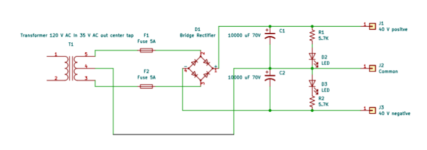

Of course the book does not give a design for the power supply required to drive the amplifier. The schematic merely specifies +- 40 V DC. The first challenge become building a suitable power supply that could provide the required voltages. I used a simple design utilizing the scavenged components.
Circuit diagram included
BOM also included and can be downloaded.
A few notes on the Power Supply construction:
  1. I used a piece of perfboard to hold all the components.
  2. The +- rails, common and capacitor connections were all wired using 18 AWG wire.
  3. Fuse holders are type BLX-A PCB Mount Fuse Holder for 5mm x 20mm fuses
  4. To quote from the Randy Slone book “The correct way to to interconnect the reservoir capacitors is to run a wire directly from the rectifier to the capacitor terminal. Then connect the rail supply wire directly to this same point, right at the capacitor terminal.”
  5. The resistors R1 and R2 are so called “bleed resistors”. They serve to safely discharge the reservoir capacitors once power is removed. D3 and D2 provide visual indication of the state of charge.
  6. Secondary fuses are a must – don’t leave these out
  7. Another recommendation from the Randy Slone book is the requirement for a “High Quality Ground Point”. All the major grounds should be bought to a single point. This will become apparent during the construction.
See my picture of the completed power supply with the transformer.
Once the build is complete, you can switch on the power and check the DC voltage on the rails. This should be around 40V for the circuit shown.
Once again, be very careful of the reservoir capacitors, they can retain dangerous voltages even after power is removed. The LED’s in the circuit should be out before the capacitors are safe.

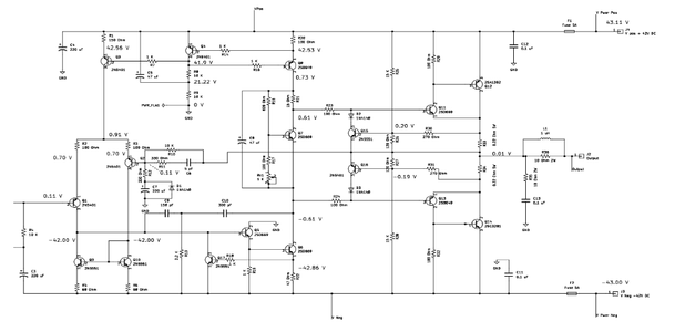

My initial test was to have nothing connected to the input or the output. In this condition, the quiescent voltages in the circuit are shown in the attached diagram. These were the tet points that
If all is well, there should be no smoke or strange popping sounds and you can proceed to the next stage of testing.

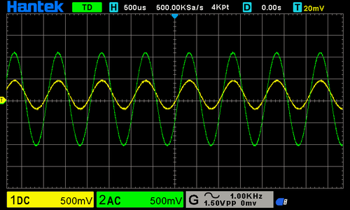

Next test needs a function generator that can produce a sine wave. Attach a ½ watt resistor to the output with a value between 500 – 700 Ohm. I used a 680 Ohm resistor. Before switching anything on, make sure the function generator is set to a very low output, say 700 mV peak to peak (about 250 mv RMS) with a frequency of 1 kHz and then connect to the amplifier. Use an oscilloscope to check that the input is present on R4 (10K input resistor) and that it is symmetrical about 0V.
Switch on. Another oscilloscope probe (set to 10x input attenuation) connected to the output should give an in-phase sine wave with a peak to peak voltage of about 22V. The gain can then be calculated as 22/0.7 = 31.4. Which is pretty close to the design gain of 31. See oscilloscope trace captured
If this all works, you can proceed to the sound test. I used an old iPod as the music signal source and a Yamaha speaker. Connect the iPod to the input via a 3.5 mm audio jack. Switch on the amplifier and start the music. If all goes according to plan, you should be playing music over your DIY audio amplifier.
