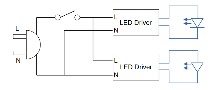

Step 4: Electrical Wiring
The final step of construction is to complete the wiring. A schematic is included. The 120 V rocker switch must break the live wire from the socket outlet.
The LED drivers can be mounted on the back of the light box and then connected to the pigtails that come from the side panels.
Use insulated straight wire crimp terminals and insulated spade crimp terminals to connect the various items. Heat shrink is necessary to insulate the connections.
See pictures for the completed wiring and finished light box. It is now ready for use

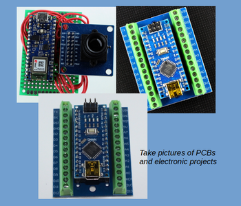

Step 7: Results
Here are some of the pictures taken using my light box and DSLR camera.
