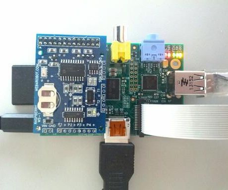

Step 1: Hardware
To recreate this experiment you will need the following hardware (in addition to the Raspberry Pi itself):
Plug the GPS module into the breadboard as shown and connect red to VIN, black to GND, green to RX and white to TX, using the jumper wires and the USB to TTL serial cable. Plug the USB end of the cable into the Raspberry Pi (powered down). Power up your Raspberry Pi.
The GPS module starts to transmit data shortly after power up and will
continue to do so until it is unplugged from a power source.

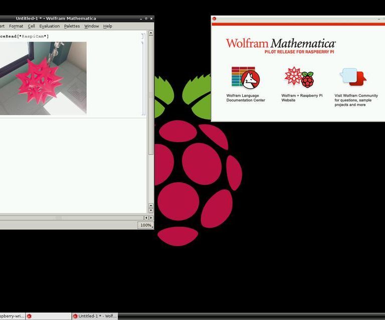

Step 2:
In a terminal start the Wolfram Language using the following command:
> wolfram
Wolfram Language (Raspberry Pi Pilot Release)
Copyright 1988-2013 Wolfram Research
Information & help: wolfram.com/raspi
In[1]:=
