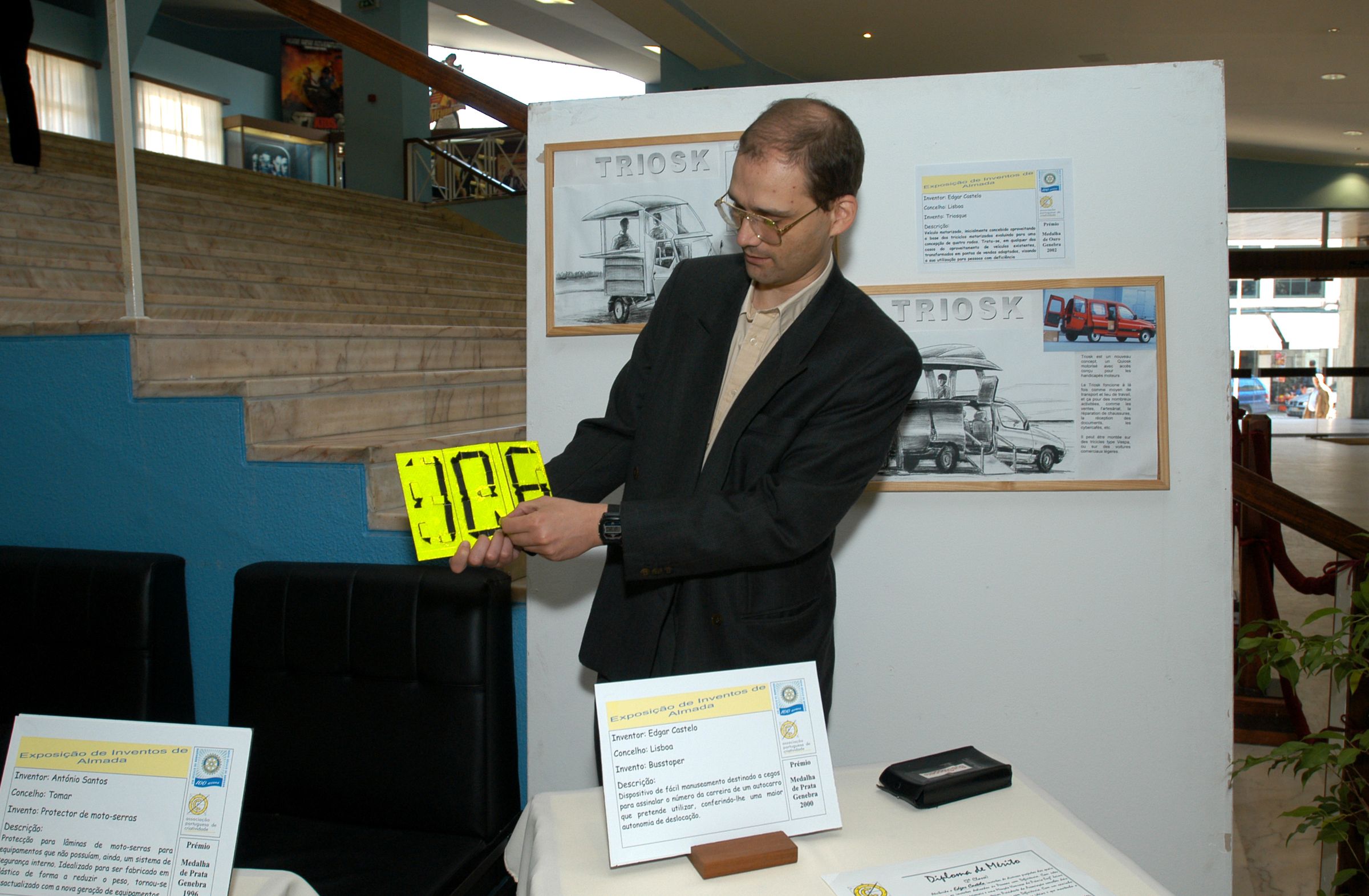

The thing will look like this, showing the plate all blank, and showing numbers up to 199.
All parts turned up, 188.
And you turn them thusly, see Video:

Now, it's all assembled, you can train the Visually Impaired into setting the numbers, a Braille table with the relief of the digits will do wonders.
