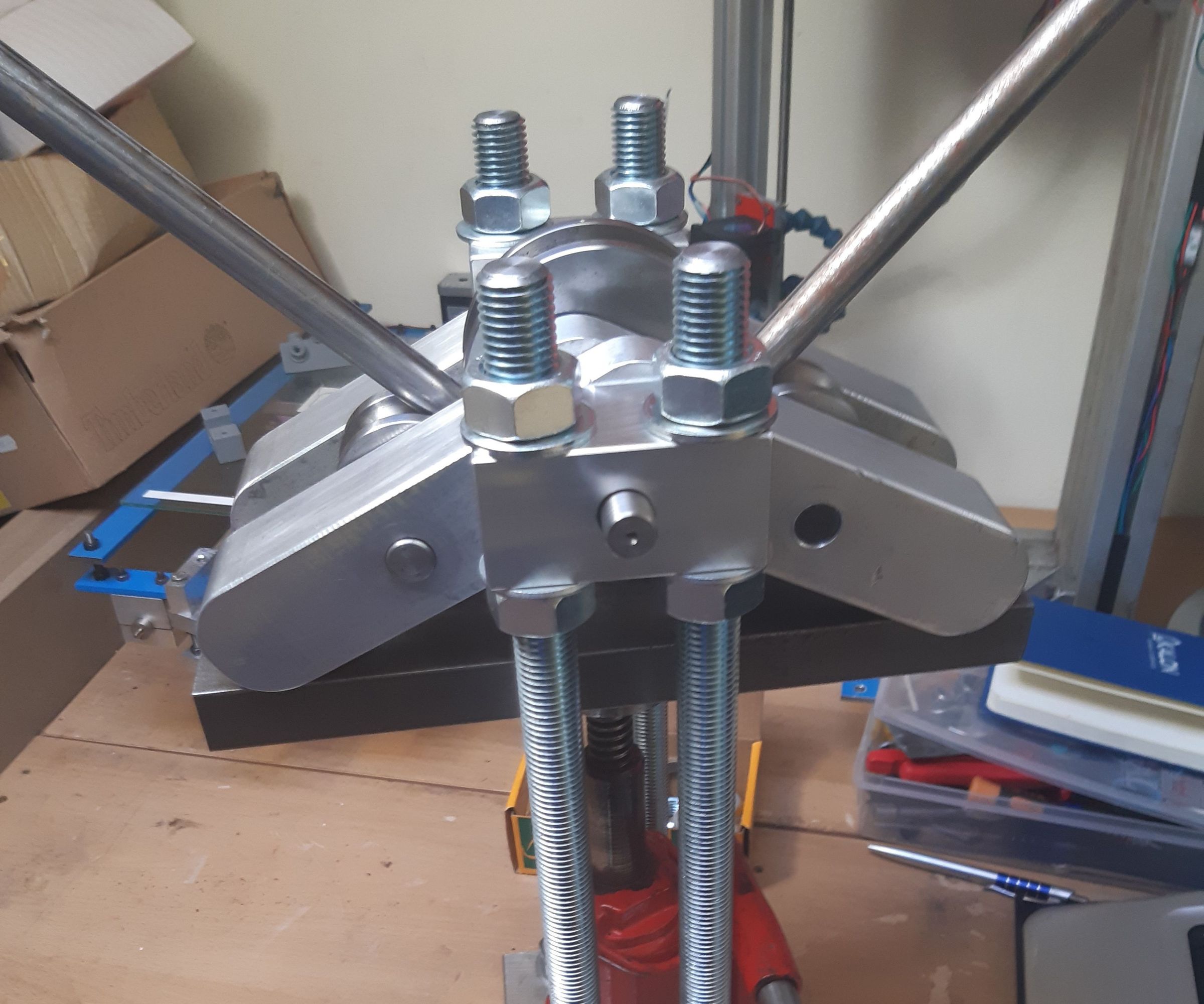

The jig has a 12mm reamed hole and has 18 scratches to use to carve the 18 gear teeth.On the other side it has two threaded holes, one threaded to M12x1.5 right and another threaded to M12x1.5 left. the distance of these holes from the 12mm hole is 9.8mm. This is important to be correct, because the depth of the gear teeth will depend on this. My advice is that you make the threaded holes before the 12mm hole so that when threading the male does not deviate.
Step 3: CARVE THE FIRST TOOTH
Turning the part that will be the gear. One part at 12mm and the other with a larger diameter, so that it stops. Make a line in the part with the largest diameter that will serve as zero.
Place the part on the template, place the zero on the one line of the template, clamp the assembly in a vise, and thread. In the photos you can see how, and the result.
Step 4: CARVING THE REST OF THE TEETH
Repeat the previous operation in all the lines of the template, and the result is what you see in the photo.
