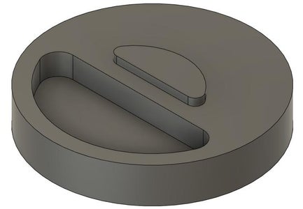

Step 1: Base CAD
The base is modelled with one sketch, and extruding the base and walls.

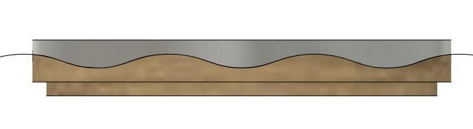

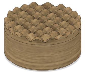

Step 2: Lid CAD Pt.1

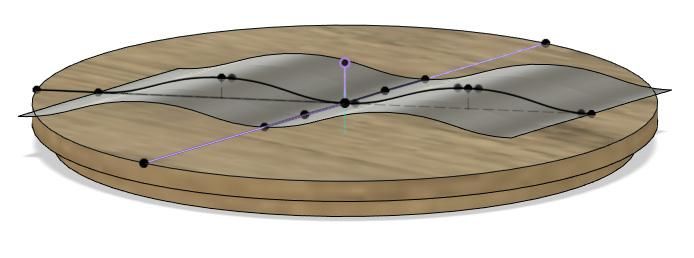

The lid is made using a projection of the previous sketch and extrudes for the top and inner. The wave is then projected as a plane

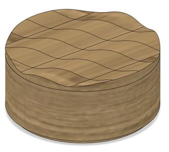

Step 3: Lid CAD Pt.2
The lid is then split, and the plane and remaining body are removed.

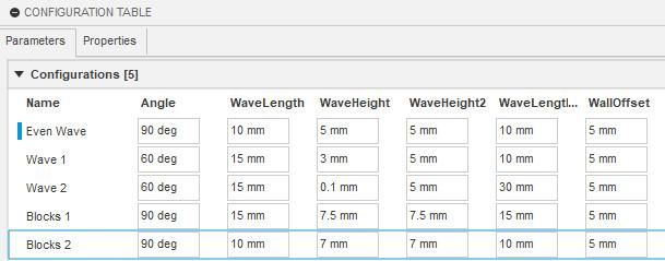

Step 4: CAD Configuration
All measurements have functions and are configured to create different shaped lids.

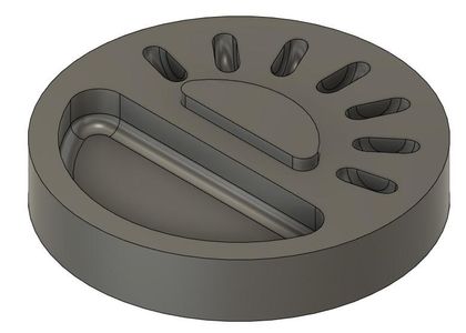

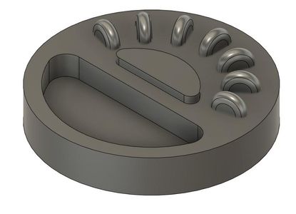

Step 6: Insert CAD
The insert was made by extruding the internal diameter of the outer box. I then sketched the two profiles on the top and extruded. The ring slots were made by revolving a shape and then creating a partial circular pattern.

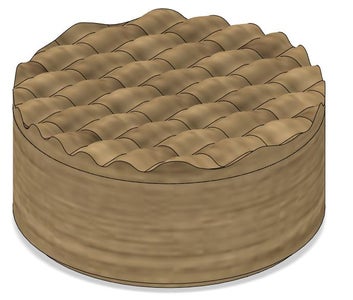

Step 7: Final Prototype
We milled the final prototypes using a flip cut on both the wooden base using a 6mm square end mill and the Lid using a 6mm ball nose end mill. The cork insert used a 6mm ball nose end mill. We used a glued-up piece of oak for the base, and the lid used a scrap piece of hardwood.
Step 8: Final Project: Thoughts
The final product for manufacture would have been made from a slab of oak sourced locally. There were also plans to use die-cast metal to make a mass manufactured version.
