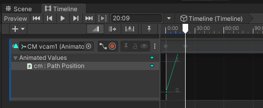

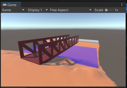

In Unity, I imported both my bridge model and my canal and applied appropriate materials to each. I filled the canal with a transparent to represent the water that is usually there. I created a timeline and placed a Cinemachine camera on a track to circle the bridge. I used the video recorder functionality to export a high quality video.
I then took the video and uploaded it to ezgif.com to change it into an animated gif. Hopefully the animated representation of the bridge over the canal grabs the attention of the people that can give me approval to move forward on this project.
