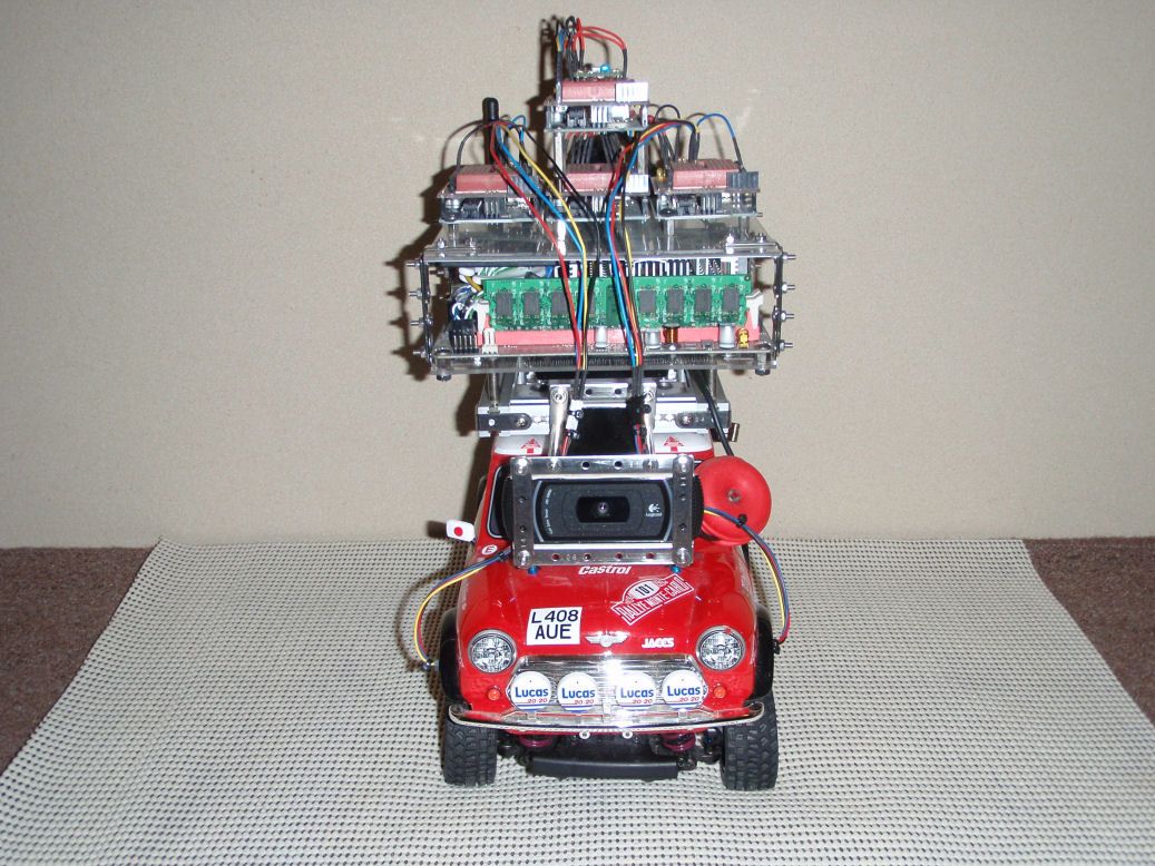

I have altered Car No.05 by lowering total car height and replacing Web Camera.
Now I can manage Tamiya TEU-104BK Speed Controller for backward driving.
Also I have solved the problem in continuous rounds driving.
The general outline of Car No.05 Altered (Full Chocolate Version) is same as that of Car No.06, but detail contents are different from that of Car No.06.
Car No.05 Altered (Full Chocolate Version) is a programmed automatic driving car using Reflective Photosensor, Gyro Sensor and Web Camera, which is composed of 4-Wheel-Steering chassis, R/C Car body and Car Top PC with 4 Arduinos and Web Camera.
I have solved the problem of Car No.06 in continuous rounds driving with revising Processing codes.
Please watch the following Car No.05 Altered test run video.
Car No.06 had failed at 3rd round. But this Car No.05 Altered has succeeded up to 11 rounds!

Step 1: Material
R/C Car
- Car Body Tamiya 8085258 Mini Cooper Monte Carlo 94 Finished Body
- Chassis Tamiya M-03R chassis x 2
- Motor 380 motor x 2
- Attaching Jig Kawada B57 x 2
- Servo Futaba S3003 x 2
- Speed Controller Tamiya TEU-104BK
- NI-Cd Battery for R/C Car 1500mAh 7.2V
- Lubic
- Plarepair
Car Top PC
- Motherboard ZOTAC IONITX-C-J
- Memory DDR2 2GB
- HDD SUPER TALENT FTM16GL25V
- Wireless LAN Intel Wireless WiFi Link 4965AGN
- Battery JTT Energizer XP8000
Arduinos
- Arduino Duemilanove x 2
- Arduino UNO x 2
- Arduino ProtoShield Kit DEV-07914 x 4
Tachometers
- Reflective Photosensor Rohm RPR-359F x 2
- Resistance 510 ohm x 2, 47k ohm x 2
Gyro
- 3-axis gyro ITG-3200
Web Camera
- Logicool HD Pro Webcam C910
- Lubic
- Plarepair
Car Top PC
- Memory DDR2 2GB
Arduinos
- Arduino UNO x 2
Tachometers
Gyro
Web Camera

Step 7: Car Top PC With 4 Arduinos and Web Camera
Mount Car Top PC on R/C Car and Fix 4 Arduinos and Web Camera.
