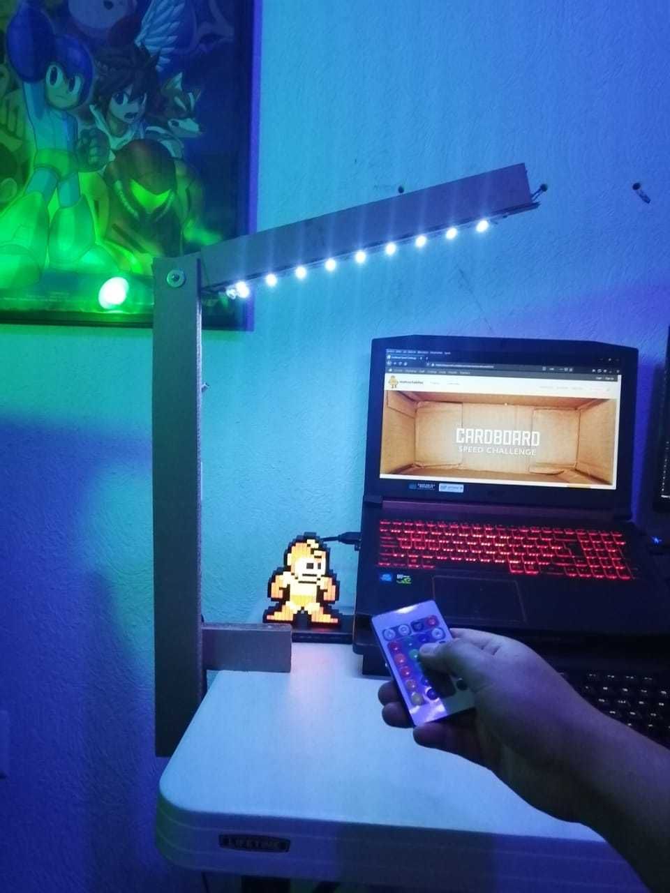

Introduction: Cardboard Desk Lamp: DIY, Easy and Functional
The idea behind this lamp is to re-use a cardboard box and create and adjustable desk lamp with minimal tools. This is a simple and useful project that takes around 2-3 hours and everybody can replicate at home with low budget.

Step 5: Final Assembly
A)
Insert the endpoints of the short arm and long arm to create a 90-degree angle. Do not glue them.
B) Using the drill and drill bit, make a hole in the center of the union of both arms.
I DO NOT RECOMMEND THIS OPTION: BUT IN CASE YOU DO NOT HAVE A DRILL, the hole could be made using a pencil or scissors by holing each segment at one time. Unless you are using a drill, do not try to complete the hole in all the layers at once.
C)
Using washers at the top and bottom of the long arm, insert the bolt in the hole using and screwdriver. Also secure the bolt with the proper nut at the back. See picture "Step5 C".
D)
Glue the C clamp and the long arm.
E)
Glue the shorter arm and the support for L.E.D. strip (rectangle of 14 x ¾).
F)
Mount L.E.D. strip on its support by using the adhesive that the strip has included. Notice the connector for power supply should be left on the extreme that is closer to the longer arm. See picture "Step5 F".
G)
Mount your lamp in your desk.Then, connect the power supply to the Power strip AND THERE WAS LIGHT!
(See picture 1, 2 and 3).
