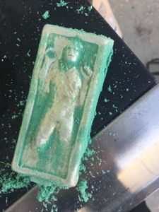

Let it cool. You can remove the cast around 30 minutes after you pour if you wear leather gloves because it is still going to be pretty hot. Insert a metal or wooden rod into the sand and pull the cast over. Then use a nylon brush to clean off the moon sand. Don't use water on the cast until it is fully cooled.
I ran out of pewter on my first attempt only filling the mold 2/3rds from the top. I also had some wavy edges. The nice thing about working with pewter is that if it doesn't turn out the way you want it to you can just throw it back in the pan, melt, and try again with a new mold. The last picture is my 5th try using the same pewter. It has really good detail and will probably be a keeper.
