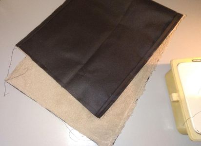

Step 4: Make External Part of the Cave
  1. Join pieces of fabric: Join cuts A, B and C of sherpa fleece and sky canvas, back to back, 1 cm from the edge respectively.
  2. Sew a strip H 1 cm from the inner circle of faces B and sew it as bias binding: Place right side of strip with outer face of B, sew at 1 cm, then turn inside out, make a double and sew again at 1 cm.

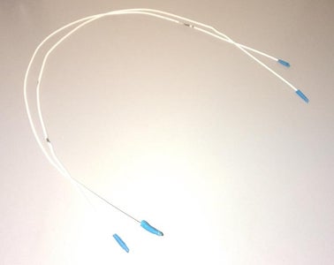

  6. Cut wire and put adhesive on the ends. Move it to give it an arched shape.
  7. Insert the hooks

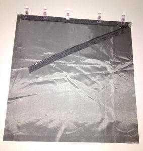

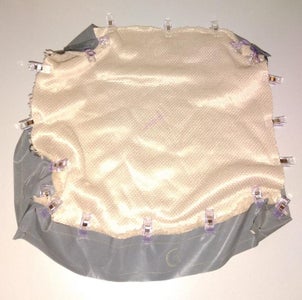

Step 5: Make the Cushion
  1. Sew leaving a seam allowance of 1 cm from each right side to right side of F, making a square "ring".
  2. Sew part E of sherpa fabric all around the edge of the resulting hoop, with 1 cm seam allowance, joining right side to right side of the fabrics.
  3. Sew zipper on the taffeta piece E, 1 cm from the edge: Place zipper strip on the right side of one side of the square F, place the other zipper strip on one side of E, sew right side to right side. Finally close with single stitching on the sides of the zipper.
  4. Sew part E above 1 cm from the edge to the cushion frame.
  5. Turn cushion over.
  6. Stuffing.
