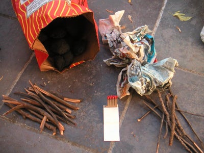

Build Materials:
  • Coffee can (or other large, tin-plated steel can)
  • Coat hanger (no fuzz, plastic etc., just bare wire)
  • Small can (from olives, individual servings of pasta sauce, etc.)
  • An abundance of caution. This will be used up quickly, due to all the sharp edges and dangerous tools involved. If you lack caution, be sure to have a few units of blood and a field suture kit, instead.
Build Tools:
  • Can opener (both cut-around-the-lid and punch-a-triangular-hole)
  • Needle nose pliers
  • Tin snips, or similar (I used the black ones shown)

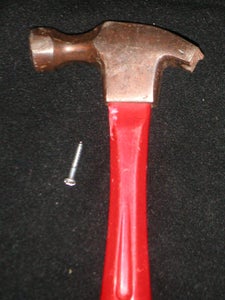

  • Hammer
  • Nail Um...or similar.
Use Tools & Materials:
  • Pot holder or oven mitt
  • Charcoal, or other solid fuel
  • Paper, cardboard, small wood, or other tinder/kindling
  • Matches, or a live coal stolen from the neighbors

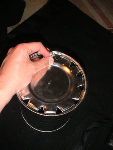

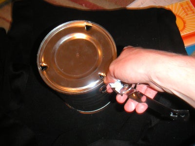

You will be making a grate to support the coals as they are lit. Fire needs air, so, to ventilate the coals, we're going to use a punch-type can opener to poke holes all around the edge of the can bottom.
Three legs make for a stable platform (if you've studied geometry or dairy farming, you know this already), so to start with, we'll punch the holes for the legs. Try to make them evenly spaced around the circumference, as shown in the first picture.
Next, punch three more holes, evenly spaced between the three you've already made. Then, go back and punch six more, again evenly spaced between the six you've already made. Set the can opener aside when you have twelve evenly-spaced holes.

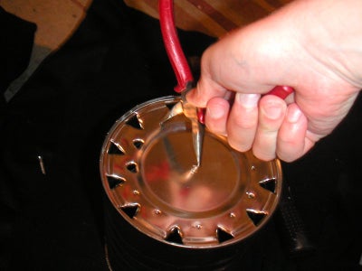

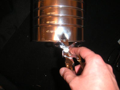

Okay, now for some danger. Take a nail or nail-analogue, and punch holes about halfway between the inner points of the twelve holes you already have (second picture). Punch one in the center, as well. Now, go back around the outside and widen each "nail" hole with the pliers, until one jaw of the pliers can fit most of the way into the hole, as shown in the third picture. Work both jaws of the pliers into the center hole, making it a little bigger than the others.

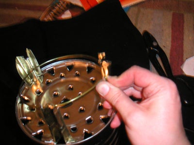

Lastly, punch six more holes, using the same method, in a ring around the central hole. The finished grate is shown, from the inside, in the final picture.

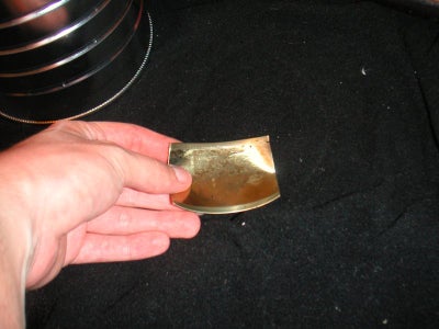

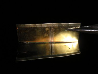

Using tin snips, cut the can from top to bottom, as shown. Cut twice again, in the same direction, to form three, roughly equal-sized rectangles of steel, as shown in the second photo.
Using the pliers, straighten the rolled-over edges slightly. You can finish straightening them later.
Fold each rectangle in half, so that the rolled-over edges meet. The photo shows the beginning of this fold, with only the sharp edges creased. Once they've been folded over, use the pliers (or a vise, or your hammer and an anvil) to flatten them the rest of the way.

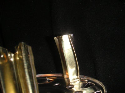

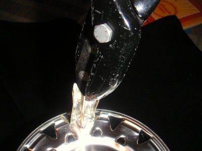

Next, place the crease of one of the feet into the point of one of the holes along the outer edge of the coffee can, as shown in the third photo. Did you forget which holes were for the feet? Pick one...but remember this time, since they might be different sizes. Mark the length of that edge of the hole onto the top of the leg, using the nail, a grease pencil, or a marker.

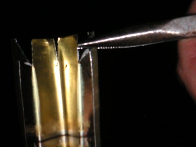

Cut about 1/2 inch along this mark, as shown in the fourth photo. This cut creates the tab that will attach the leg. Using pliers, fold along the line of that cut, all the way to the bottom of the leg. Repeat on the other side. From the top, the leg should now resemble the letter W.
Now cut about 1/2 inch down the apex of the W, to match the fifth photo. This makes two squarish tabs, which can be folded down once the leg is installed. Using the pliers, bend over the triangular section of metal between the outside cut and the folded-over edge of the leg. The same photo shows this process.
Once the triangular pieces have been bent over, take the two outside tabs, with the folded over edge, and bend them toward you at a right angle, as shown in the sixth photograph: these two tabs will form a platform that supports the can.

Once you've made arrangements for the coat hanger, install the first leg, as shown in the sixth photo. Insert the two center tabs into the hole they were cut to fit in. The ninth photo shows the tabs from inside the can; bend these down so that they lie flat against the can bottom.

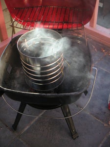

Step 5: Kick the Tires and Light the Fires.

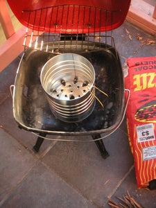

Make sure you have a pot holder handy, unless you just want to roast marshmallows over the tin can.

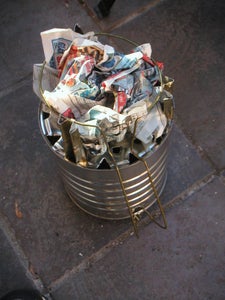

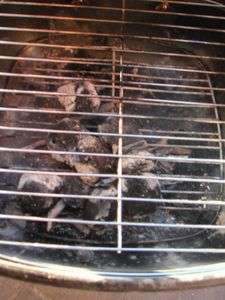

Put paper between the legs, some charcoal in the top, and light it up! Do be careful about the fire, though.
When the coals look red in some places, with a little ash showing, you can use the hot pad to dump them out, and you're ready to grill.
