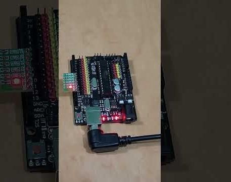

This is an Arduino project that drives a WS2812B Addressable LED panel with the push a the button. The lights cascades from clockwise to counter clockwise on the circle or snakes its way from one side to the other on the square. you can use a strip if you prefer
https://youtube.com/shorts/yc9sM284M7A?feature=share
Addressable LED, this project is designed for 16 but can be added easily by changing the number values
One 240 Ohms resistor and heat shrink tubing
One or two three pin male to female cable/s
One three pin female to female cable

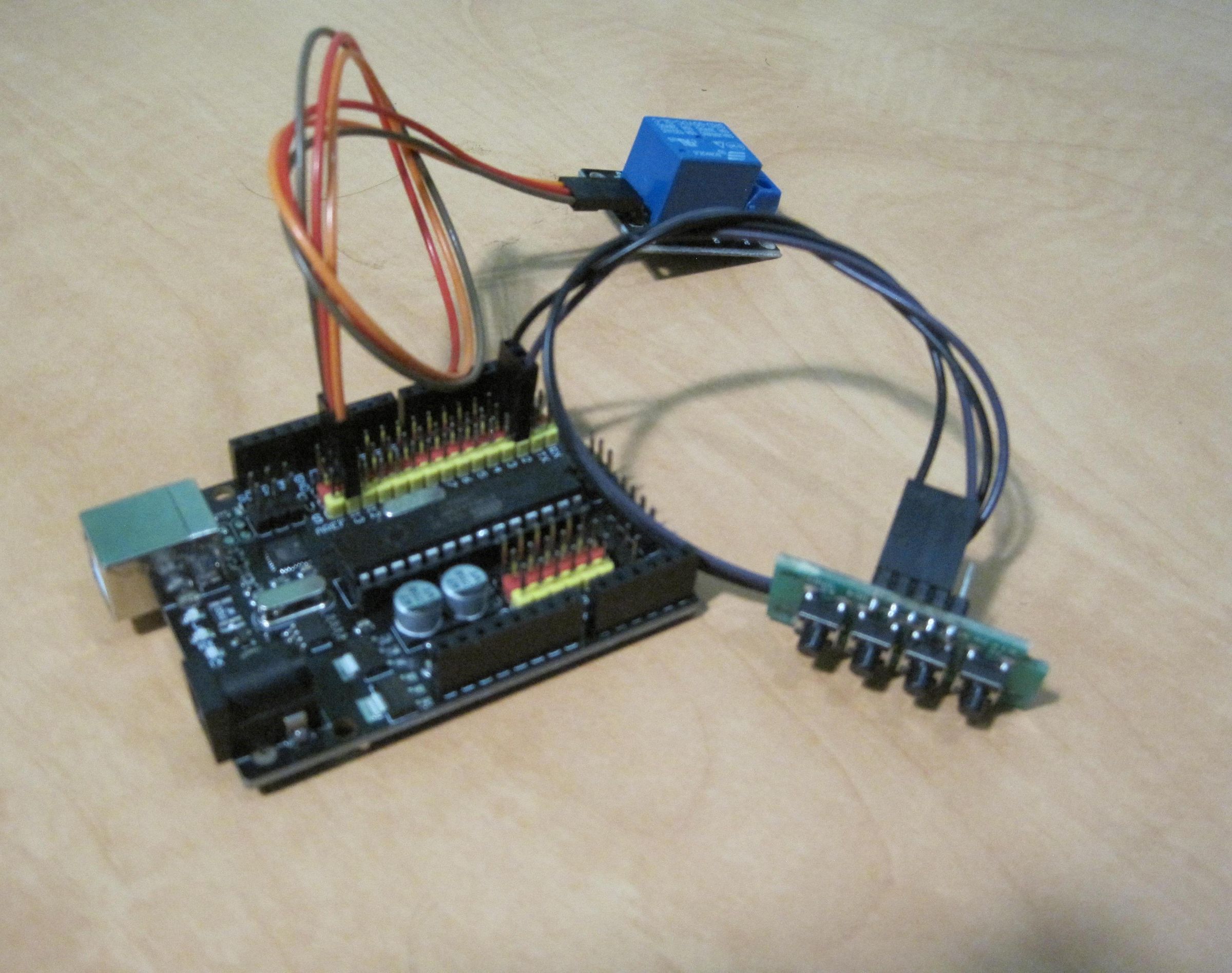

Two pushbutton Switches, I used a 8 button
One 3 pin connector
Step 1:
First cut and strip back the insulation on of the three pin wires that will be the data line on the female to female cable. Solder the resistor between the two wire segments. When cool use the heat shrink tubing with a heat source to reinforce the cable. My Arduino bord has ground 5V and Signal in a nice 3 rows. They are indicated by ground / black, red/ 5v and signal / yellow. You may but its is more likely will need to connect pin 9 and 240 Ohms resistor wire, ground and 5v with single wire cables individually.

Break off 3 pins from your strip if needed and solder so that the 5V pin is in the center if posable. This will prevent accidental shorting of your 5V to ground. Data line shorted to ground dose no harm.
Step 3:
Attach the ground pin to the ground with the other two pins connecting to pin 13 and 12 to the pushbutton switch ground and the two pins closest to the ground
