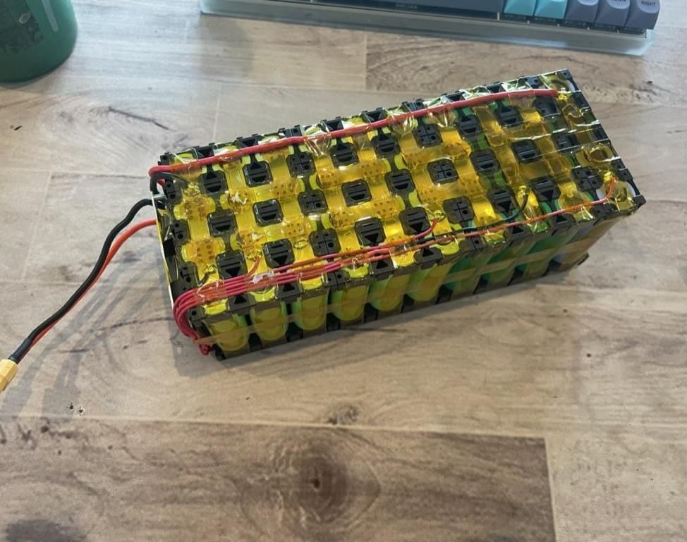

The battery pack was created using 40x 18650 3350 mAh lithium cells from batteryhookup.com. The process of salvaging and repackaging these were documented in another post of mine. This was arranged in a 10s4p arrangement to create a 36V nominal 482Wh battery pack that is still quite compact and lightweight. I used the battery size of the MGI Navigator Quad Gyro, which supports 36 holes of play at 312Wh, then increased it by 55% for funzies. That should comfortably last more than 2 full rounds of golf.
A spot welder was used to place nickel strips between the cells. The cells are placed in a 4x10 rectangle, with each row of 4 cells being a parallel group. After a painstakingly long process of carefully spot welding, I soldered the BMS board I salvaged from the hoverboard. Check out my other article on how to create your own battery packs. In the future, I'd like to use a better quality BMS, as this is critical to the safety and reliability of the device. After wrapping everything with Kapton tape and connecting a XT60 power cable, the electrical part of the battery pack was done!

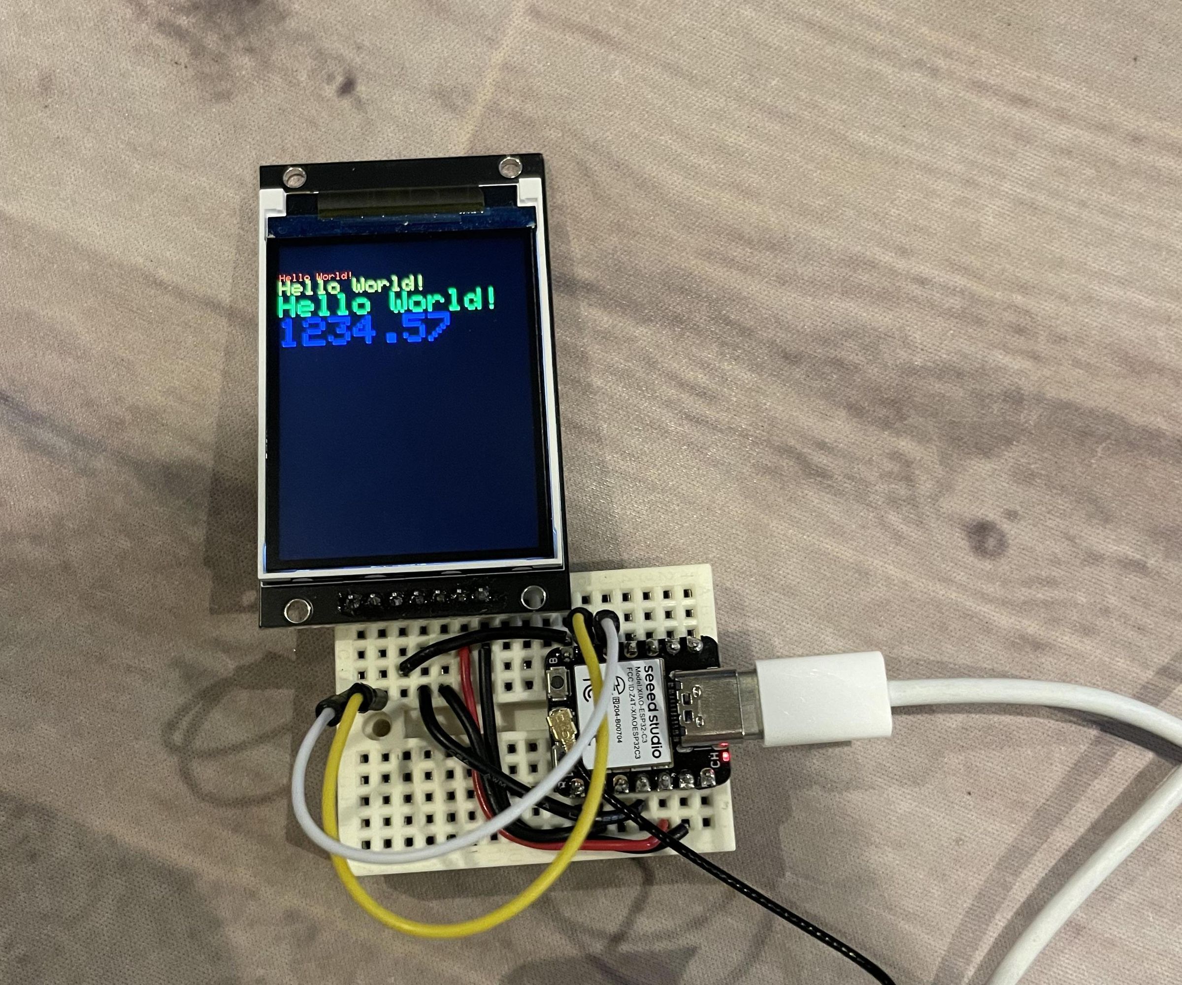

Additionally, I wanted to make the remote smaller and streamlined with less parts. That's when I discovered the ESP32-C3 XIAO board, which is the ESP32 C3 in a tiny footprint with a battery charging and protection circuit preinstalled. Hence, I set out to create a revision 2 for the remote, which can be seen in the picture. It's significantly smaller and lighter, with bigger buttons as well. This time, the communication works via ESPNOW, which is a proprietary protocol available on ESP devices. The receiver side was changed as well and equipped with another ESP32 C3 board alongside an MPU6050 for heading/balance control.
