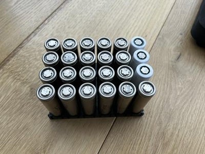

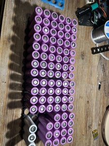

Step 2: Gather All the Cells and Inspect Them
Once you've pulled them all out, it's time to inspect each one, one by one, in order to check for any physical imperfections or damage that could've occurred while salvaging the cells. You're looking for any dents, scratches, or holes on the cell. See the above picture for an example of a dented cell. Even cells with small dents shouldn't be used at all and discarded properly for utmost safety.

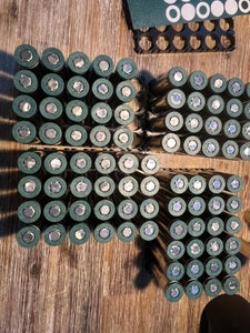

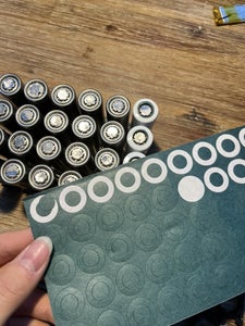

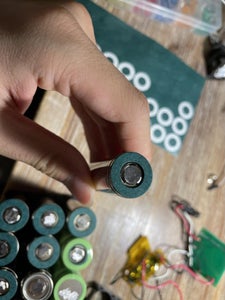

Step 4: Apply Insulation Sticker
To prevent short circuits between the anode and cathode, you must apply a sticker on the cathode side of the cell (side with the nub pointing out). Grab these stickers and stick it on!

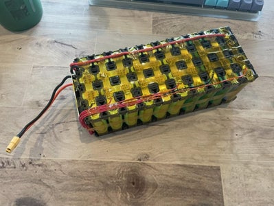

Step 7: Make Cool New Projects!
Equipped with the arsenal of 18650 cells, you're now free to make the projects that your heart desire! I've made several battery banks to an remote electric golf cart with the cells shown in this article, so you should check them out on my profile.
