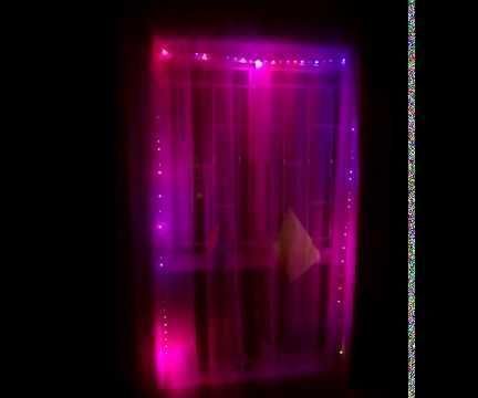

3. Hang LED strip around edge of window (it looks really nice behind our net curtain)
4. Plug in the USB cable to a wall outlet or charger and watch the lights!
Step 4: Merry Christmas Everybody!
