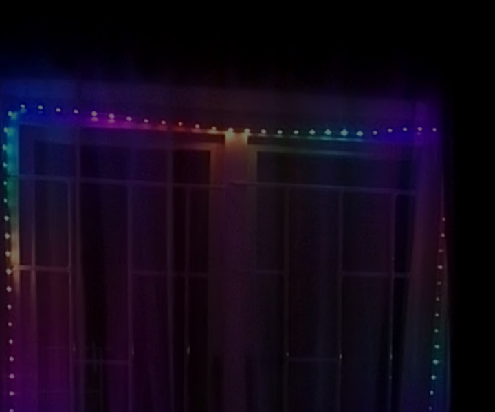

Step 3: Finishing Up
Once the code is loaded you should be able to disconnect the programming
wires and Arduino UNO. Now just hang your lights around the window (I hung mine around the top edges, behind a net curtain which gives a great effect). Also, maybe put the board and batteries in a box for neatness, or even replace the battery pack with a power supply (I may do this myself later).
Step 4: Merry Christmas Everybody!
