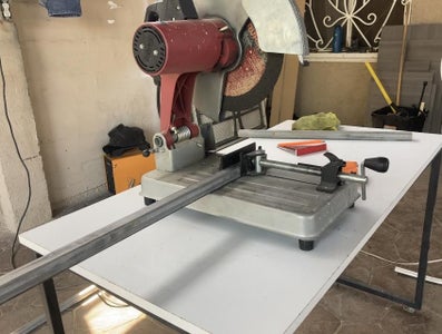

Step 1: Cut Pieces

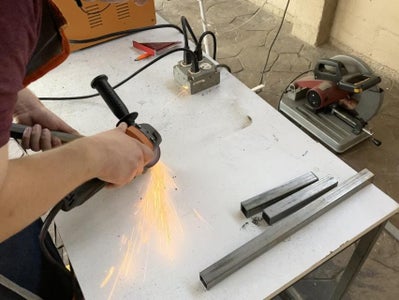

The first step is to cut the metal pieces that we need to be welded later. To cut the pieces you can do it with the help of an angle grinder or an abrasive cut off saw. In my case I used an abrasive cut off saw and it was pretty easy. It should be noted that if you use a galvanized profile it is extremely important to clean the areas to be welded with an angle grinder since welding the galvanized material can release gases that are harmful to health.
Next, I will leave you the list of cuts:
  • 2 pieces of 8”
  • 2 pieces of 11”
  • 4 pieces of 5.5”

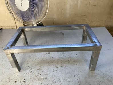

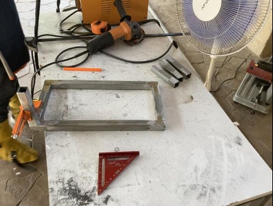

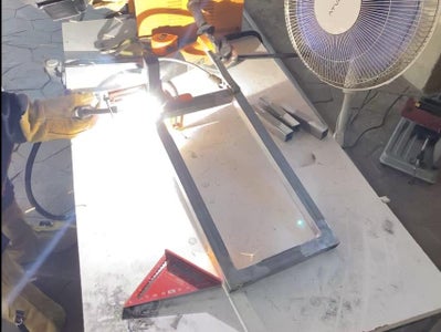

Step 2: Weld

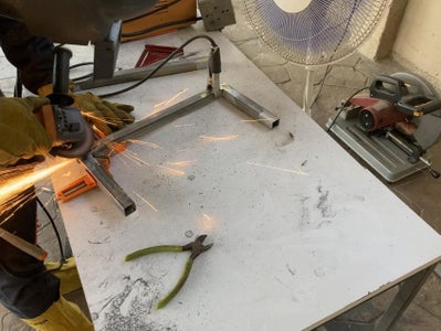

Once we have the cuts ready we can proceed to welding. It is important to be sure you have the pieces square. I add a design made in sketchup and I hope it will help you to weld the pieces correctly. Once welded, the welding of the piece can be cleaned with the help of the angle grinder, here I leave it to your liking.
