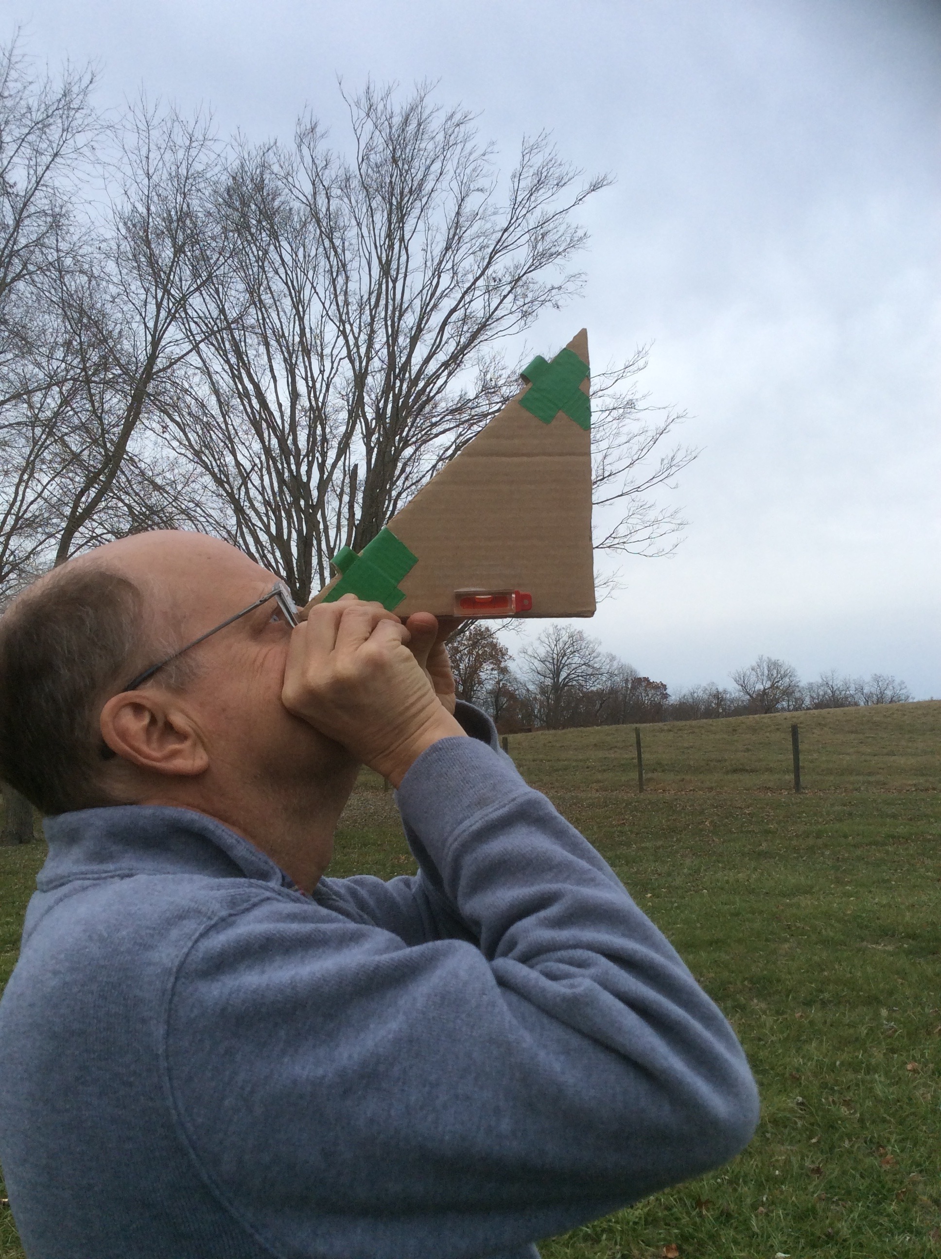

Step 5: Using Your Clinometer.
Sight through the tubes on the hypotenuse so you can see the tippy-top of the tree through the tubes. Ensure the lower leg is parallel with the ground.
You may have to move closer or farther away or side to side to get a clear shot at the top of the tree.
By sighting down the hypotenuse, you have created a 45-45-90 triangle: the height of the tree is one leg and your distance from the base is part of the other leg. Since the two legs of an isosceles triangle are equal, your distance from the base is approximately the height of the tree. You have to take into account the fact that your feet are not at the end of they horizontal leg and add the height of your eyes off the ground.
Your distance from the base of the tree + height of your eyes off the ground = height of tree.
See drawing to understand why you add the height of your eyes to your distance from the tree.
