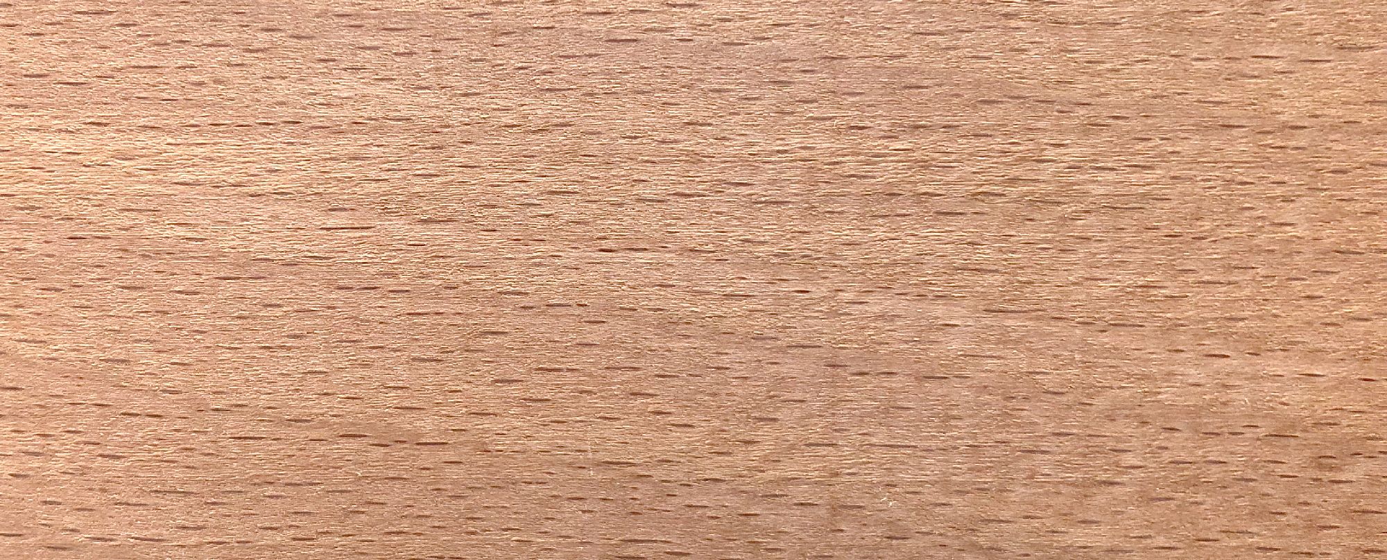

This project was made entirely of beech wood. The reason behind this choice of material is I wanted a wood that has a relatively 'quiet' texture. The joinery should be the main focal point of this design, therefore having too much grain would only distract from that. Having said that, there are plenty of other species that fits this description, so feel free to experiment with what's available in your local wood supplier.

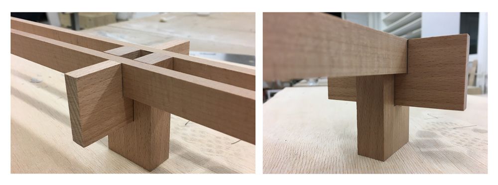

- Feed long stretchers through legs.
- Slide short stretchers in place
- Slide in long aprons
- Slide in short aprons
- Place table top in place
- Done!

- I've always loved the aesthetic of interlocking timber joinery, and I wanted to use this project to test and experiment with that. I built this mockup when I first had the idea, and this little guy gave me the confidence to proceed when I realized how strong the joint was without any gluing.
- The decision to not use glue also gave it the freedom of adaptation over time. It allows the table to be component based, changing the dimension means replacing certain parts of the table (legs or stretchers) instead of the whole thing. After all, furniture should be evolving entities that can adapt to the way we live.
- I think glass would also be a great choice for the table top since it would allow the joineries to be more exposed. Ultimately, that is where all the hours of crafting went into.
- When I was making this table I did not have writing this tutorial in mind, therefore I was not actively documenting the process. I now realized how valuable it is to see the process photos and will take this into consideration in future builds.
- A fellow Instructables member caught me on a little omission I made in my instructions. They were the four little wedges that slides under the long stretchers (seen in photos at the top of the post). I left out this detail in my writeup because I didn't think they were integral to the structure of the whole system. If you choose to include them the dimensions are 10mm x 10mm x 36mm.
