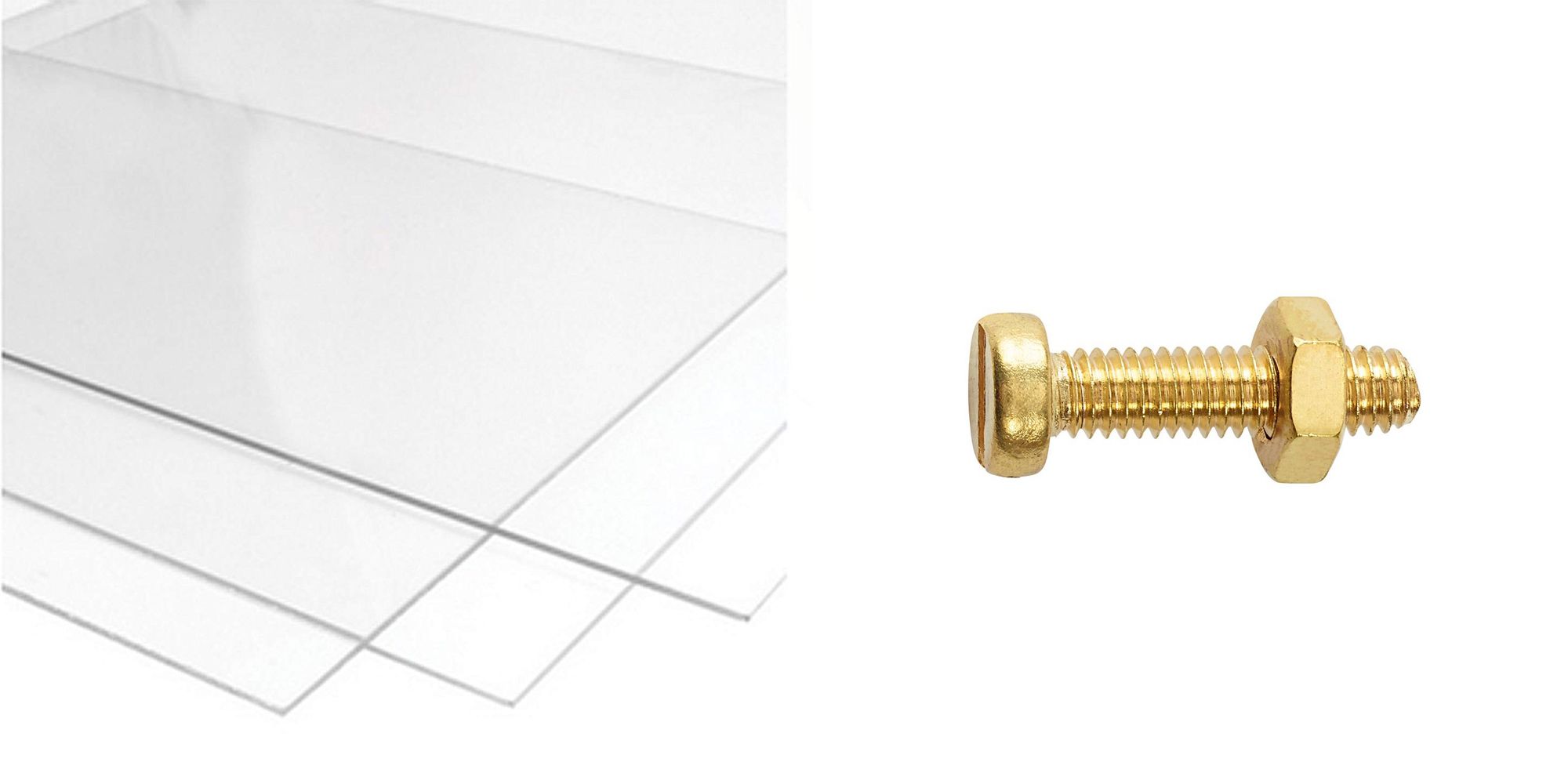

This project was made entirely with plexiglass and held together by metal fasteners. Here's a list of materials I used for the build.
  • 5mm acrylic sheet (55cm x 60cm)
  • 3mm acrylic sheet (40cm x 40cm)
  • M5 x 20mm brass machine screw and nuts (x8)
  • M3 x 15mm stainless steel machine screw and nuts (x6)
  • white spray paint
Dimensions are tailer made for a 15" MacBook Pro. But will also work for all laptops 13" and above.
